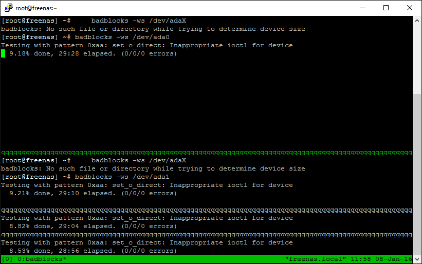

I'm here with a question also. Pardon me if these are elementary.
I had a stable "production" system, but I never finished my burn-in. So, I made backups of all data on my FreeNAS system, and right now I am running destructive tests on my 4 drives, via SSH. So, right now the system is no longer a "production" system.
These drives were part of a live pool, with a CIFS share.
Once these tests are done, assuming the drives pass, what is going to happen next? Will my system still be live, just without data? Or, will my pool be lost? What errors will I see, and where?
I assume that I'll need to start over and create a new pool.
Edit: the 4 WD Red 3TB drives are 9% through in 28 minutes and I can still access the share via Windows.
