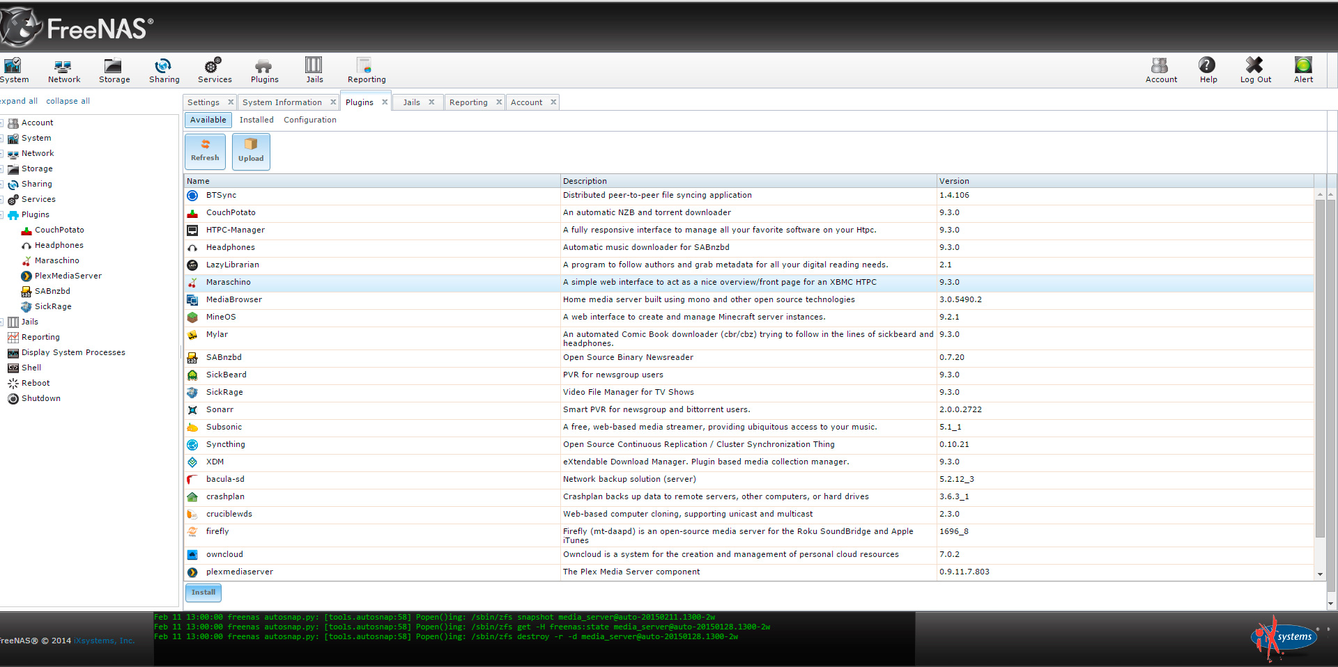

First you want to navigate to the plugins tab.
Select the Maraschino plugin and click install. (If you haven't installed a plugin before this may take a while)

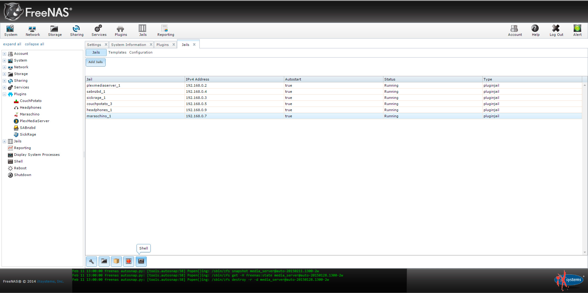

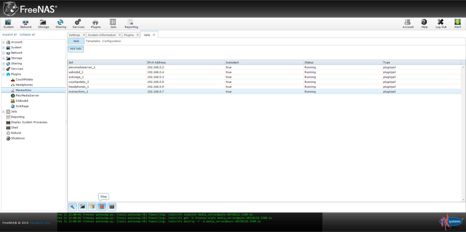

Once it is installed, you want to navigate to the installed plugins tab and make sure that the plugin is offline.
Once the plugin is offline navigate to your jails tab and open a shell into the jail.
