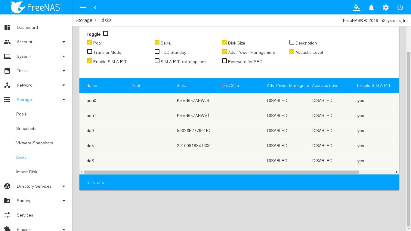

I've just started experimenting with FreeNAS on my workstation with a view to seeing if it is suitable for my needs. The workstation is a HP Z420 - if I can get FreeNAS to work I have a source of cheap Z420s that I can use to create a dedicated system.
Everything boots up fine, and I can access the GUI with no problems. However the instructions tell me that the first thing I need to do is to go to "Storage ... Volumes" and click on "Volume Manager" in order to let FreeNAS use the 2 x 500GB test disks I've installed, and that it has successfully detected.
The problem is there is no menu item "Volumes" anywhere that I can see! Not under "Storage", nor anywhere else.
Comparing my experience with an on-line video tutorial, the only difference I can see is that I wasn't presented with an initial configuration wizard.
Formatting the disks (deleting all partitions on them) makes no difference.
Not the best start to my FreeNAS adventures... I really want this to work, as I've lost about 5TB of data to someone's proprietary RAID data format... :(

Volumes don't exist until you create them. Do you see the disks if you go to Storage -> View Disks? You can also manually invoke the wizard from the GUI.

Thanks for the responses.
The version is FreeNAS-11.2-BETA2 (Build Date: Aug 1, 2018 17:7) - I want to be able to use plugins, jails etc, and this seemed to be the correct version.
I can't find where to run the wizard from on the GUI?
Yes the disks are on Storage -> View Disks.
Screenshot attached.
Yeah, iX is pretty misleading about that--you can use jails and plugins with 11.1 as well, and it isn't a beta. But that's why you aren't seeing the volumes screen; 11.2 introduces a new GUI as default, which changes a lot of things. You can either go back to the legacy GUI by browsing to http://freenas_ip/legacy, or use the manual for 11.2, which should match the new GUI.
The wizard has been mercifully removed from the new GUI.
To your original question, you'd want to go to "Pools" to set up your pool in the new GUI.

Decided to downgrade to 11.1 - that fixed the problem. I can even boot off a Micro SD card! Now the fun starts! :)
