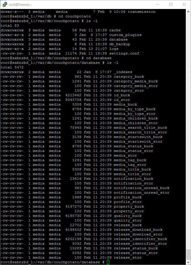

NasKar
Jan 8, 2016
739
I deleted the database file and the GUI works again. It seemed to rescan the existing movies. I made a backup of the database fold before deleting it just in case. Unfortunately I can't remember 2 of the movies in the wanted area. Can I read a file from the backup to see what they were?

Eh, same issue we are seeing here. They just need to stop the plugin, delete the /var/db/couchpotato/database directory. Restart and configure as I did in my previous post.

Deleting the database (/var/db/couchpotato/database/) from your jail would lose the following: WANTED, Quality Profiles, Media Library. The media library is rescanned when you start CP back up for the first time. A new DB is created and your media will be scanned in. The WANTED you can backup and restore using the tool I posted in this thread.
You can easily backup the database by copying:
cp -r /var/db/couchpotato/database/ /insert/backup/path/here
