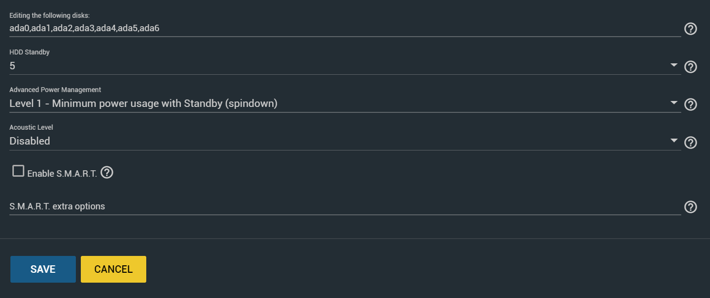

Hey there,
Recently took the dive to 11.2 and I am really loving the interface. But I am having a hard time getting the drives to standby. Yes I am aware that putting drives on standby and waking them up causes more wear, that isn't my issue, and I am not worried about electricity costs. I just hate hearing my drives always spinning even when I'm not using them, drives me nuts.
I tried a couple things, such as changing the standby time to 5, and power management. No luck.
Then i tried adding the SMART option of ' -n standby ' and that didn't work. Tried disabling SMART all together, didn't work either.
And I did move the System Dataset to a USB, still no luck.
I have 0 idea what I could be missing.
Any ideas?

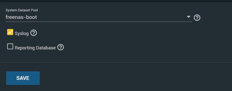

The process has not really changed much, but you missed an important step, the reporting database...
If you are going to put all that activity on the boot pool, you need something better than a USB memory stick.

Hey Chris, thanks for the links. Most of those I saw when I was googling around but I'll double check and I'll look at the one I didn't see before.
It's definitely the drives, not the fans. I live in a fairly sound isolated loft so the slightest background noise is easily audible anywhere. When I'm trying to sleep it can be awful to have a constant humming in the background.
Is a USB stick not good enough for speed reasons?
Do I just check the reporting database check mark?
Speed could be an issue but don't take that as a suggestion to move to USB 3.0 as they introduce even more problems with reliability. The problem is that all those things you are moving to the boot media (system dataset, syslog and reporting database) cause drive activity. All that drive activity is more than most USB memory sticks can handle and they tend to die without warning. I had two die on me in less than one year. I use mechanical hard drives (small capacity, 40GB drives) instead of USB drives now.
That will help, but it still is not the whole story. You may also need to ensure that your system swap is moved off the data pool.
You may end up being a trail blazer if you get this working on the latest version of FreeNAS, but it has all been documented before. Just do some searching on the forum. I did it myself, a long time ago, but I have not tried it lately.
