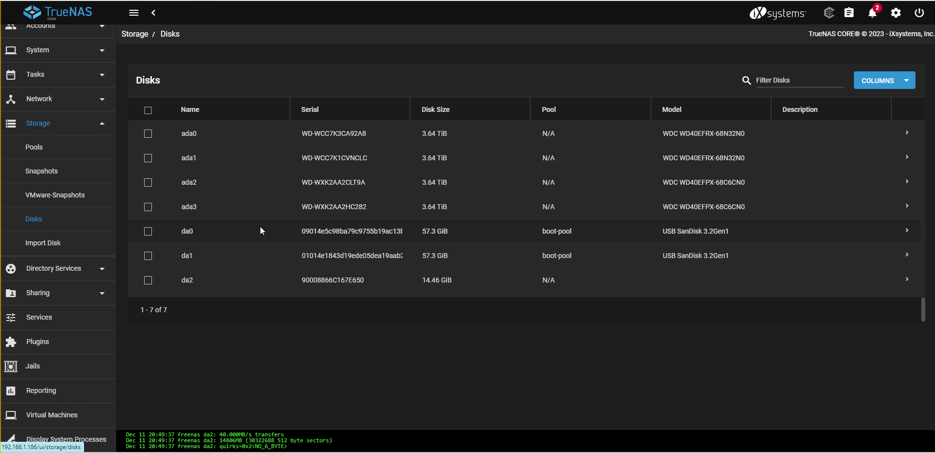

Hello, I have a server running TrueNAS 13 which has been running with two usb drives for the boot-pool and a single storage pool of two 4tb drives in a mirror vdev for many years. This pool is geli encrypted as it was originally created when the server was built, running FreeNAS 11, but the server has since been upgraded all the way to TrueNAS (13.0 U6). This is my drive setup, the bottom entry is not relevant, it's just a flash drive plugged into the host:

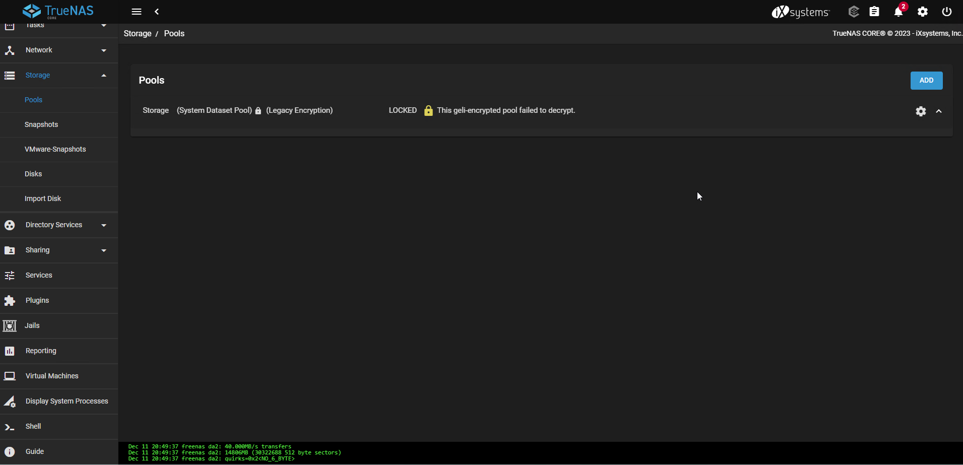

I then used the menu under Storage > Pools > Gear Icon > Add vdevs. This appeared to work as expected (and I downloaded the new encryption key when prompted), but eventually the server was rebooted and now the entire pool fails to decrypt. When I go to Storage > Pools I see this:

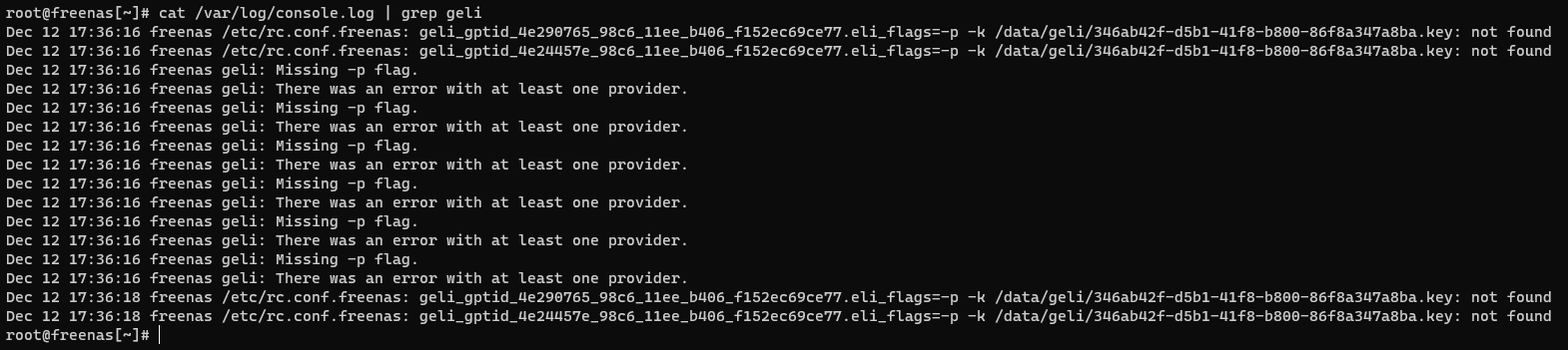

When I look for geli in console.log I see several entries which seem to indicate either the geli provider or the key file are incorrect

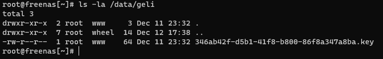

The key still exists in the proper folder

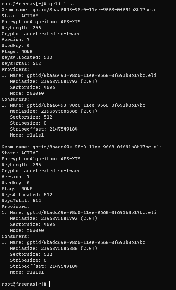

The geli list still shows two providers as expected, but they appear to have different geom IDs than TrueNAS is expecting

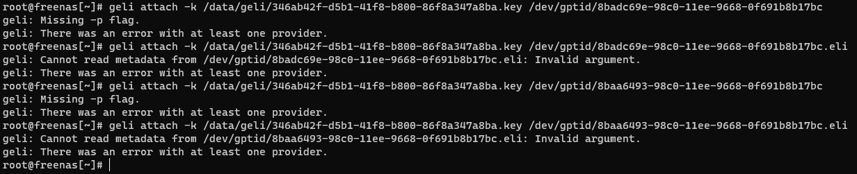

  • Run
    geli attach
    with this key but the proper geom names
  • Run the same but with the encryption key I downloaded when adding the new vdev, same results as above

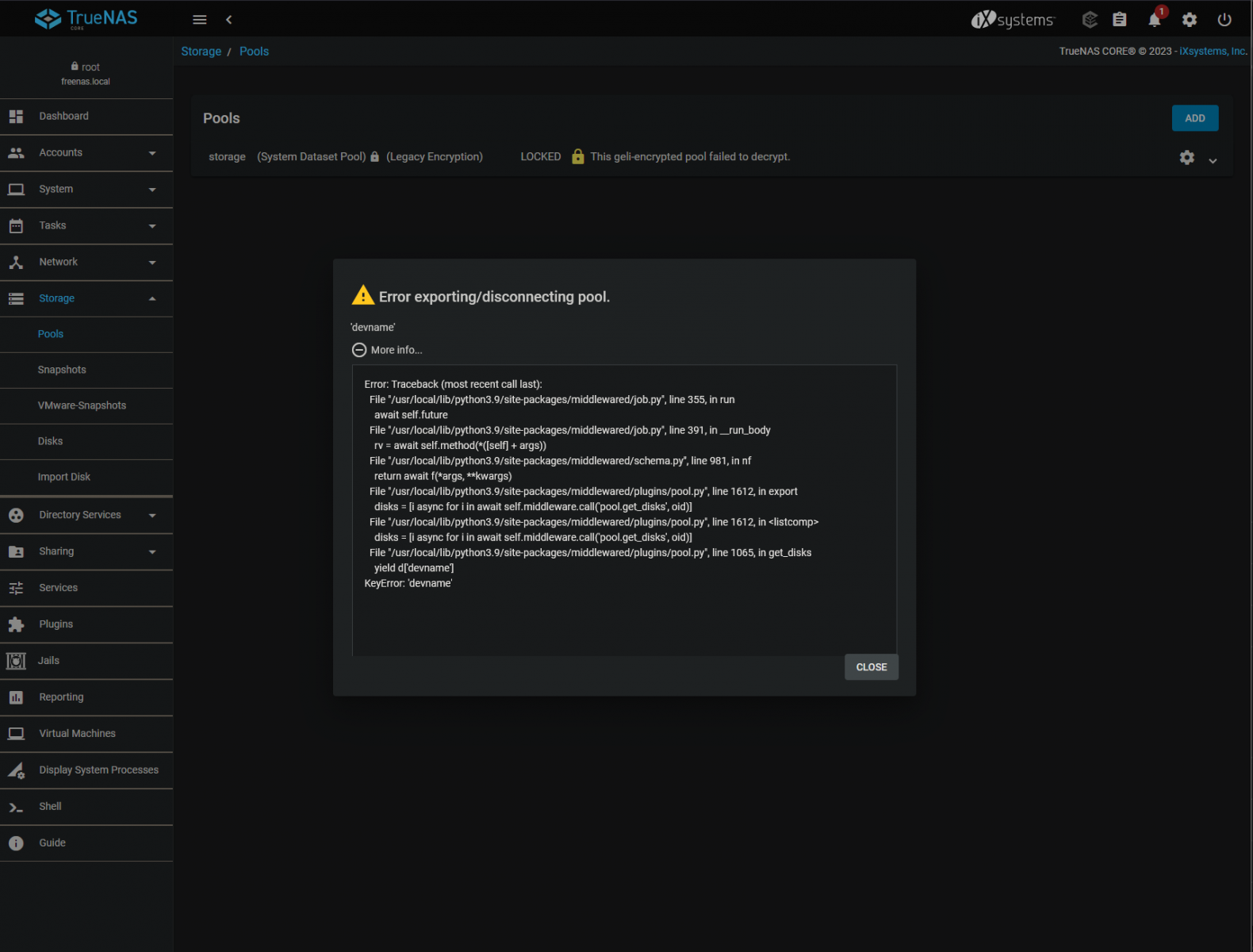

  • Export/disconnect pool in UI using the gear icon menu so I can try to reimport it, fails to export

    • Also tried to
      geli attach
      after this, both with the key originally on the server filesystem as well as the key downloaded when adding a vdev, but in both cases I see the same "error with at least one provider" shown above

I'm back into the pool! Although there was no option to downgrade to 12 on the impacted server, I tried the default boot option which took it back to truenas 13 release. From there I was still able to disconnect/export the pool then reimport it with the key from when I added a vdev. Now I need to figure out how to safely upgrade the encryption on this pool as I can't update TrueNAS any more until that's done.
