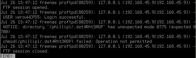

In the xferlog in /var/log these 3 lines:
freenas proftpd[34221]: 127.0.0.1 (192.168.45.9[192.168.45.9]) - NOTICE: directory '/bob/ .dstafBTusJW' has unexpected mode 0775 (expected 0700)
freenas proftpd[34221]: 127.0.0.1 (192.168.45.9[192.168.45.9]) - chmod(/bob/ .dstafBTusJW) failed: Operation not permitted
freenas proftpd[34221]: 127.0.0.1 (192.168.45.9[192.168.45.9]) - FTP session closed

I've tested the FTP logins using an ftp client (WinSCP) and logs in ok, but when i test the scan on the Xerox, i receive the 3 lines, and the scan doesn't go through. Can someone help me decipher what chmod failed operation not permitted? or some things to try to get this to work?

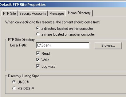

i'm not sure...in the current working setup, i have a windows machine setup, but one of the settings is set to UNIX file structure.

here are the settings/screenshots from my current working Xerox setup on a windows IIS machine and on my Xerox
  • screenshots.pdf

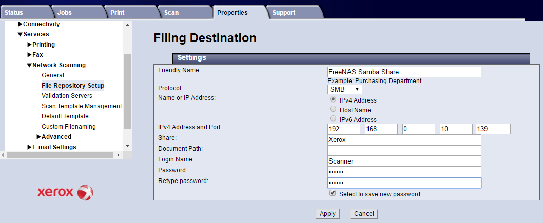

I'm trying to get freeNAS to work on a WorkCentre 5325. I have Xerox Phaser 3635, WorkCentre 7545, 7232, 7242, 7835 working on the same Windows IIS machine.
You can simply have the MFC printers scan to an SMB (CIFS) share hosted on your freenas server. See attached screenshot. If you have some other reason to prefer FTP over SMB, then you might be able to add the parameter paramter I listed above as an "Auxiliary Parameter" under "services" -> "FTP".

Thanks for posting the screenshot. That's what I was alluding to.

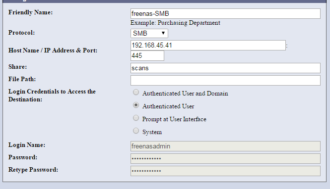

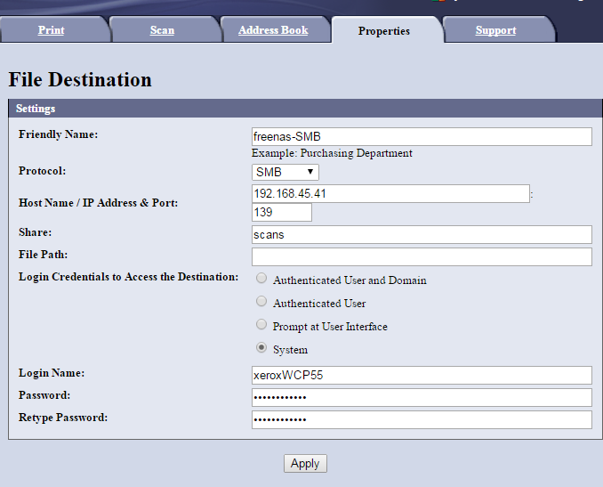

I wouldn't mind switching to SMB instead. I use FTP because it's always been used. ok so i made the necessary adjustments, but the scan didn't go through. There's an error, but where are the log files that are associated with CIFS/SMB?
xeroxWCP55 is a local account on freenas
I also tried using freenasadmin (an admin on the freenas box). I'm going to try adding the code in the FTP auxiliary settings...

Try changing the login to "authenticated users". You might also want to try port 445.

when i enter the code in the aux parameters, the scan doesn't go through. same error message in the xferlog:

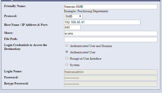

scan doesn't go through either by changing to Port 445.
and when i change the login to Authenticated User, a promp shows up at the xerox machine, but there's already something typed in (masked ********), so i press scan again and the scan doesn't go through.
