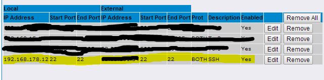

I'm trying to most simplest thing right now and that is trying to connect to my nas via SSH. i don't think me using 2 NIC's separately(meaning no Link Aggregation) would do any harm? I have the on board NIC connected to my ISP router and dedicated one for my internal network.

I'm not going to leave ssh open, i'm just trying to test a connection from outside my own network. but i'm ending up with no results and i don't understand why. I don't know what else i have to put the 4th external IP is my outer IP from my ISP router. if i'm doing it wrong than i really don't know how to configure ports no more LOL

I've already figured out my problem, thank you in advanced for all yours help :-D my router has a strange way of configuring external IP. i have to use 4*0 on my external ip
