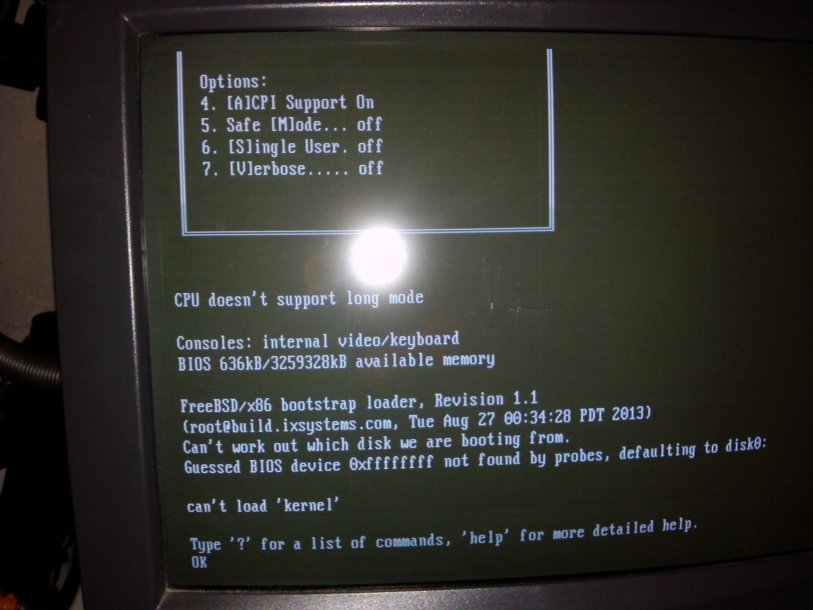

Anyway, I installed a second 2Gb RAM, so there is 4 GB RAM, the max of the mobo. But when I'm trying to install the 64 bit version I get the message "CPU can't handle long version"
Then there is also the text on the screen saying that it can't work out which disk we are booting from. It has to boot from the USB stick, that's what it always did.
Again, when it was an windows pc it was a 64 bit one.
Does someone have an idea what to do about the CPU that can't handle long version?

(see the screenshot)

cyberjock

What CPU do you have installed on that board?

Yeah.. I was gonna say there's no way its a 64 bit CPU if FreeBSD is saying long mode not supported. That's why I wanted the model.

Only intel core 2 duo and later are 64 bits.
Pentium 4 certainly aren't. Core Duo aren't either
