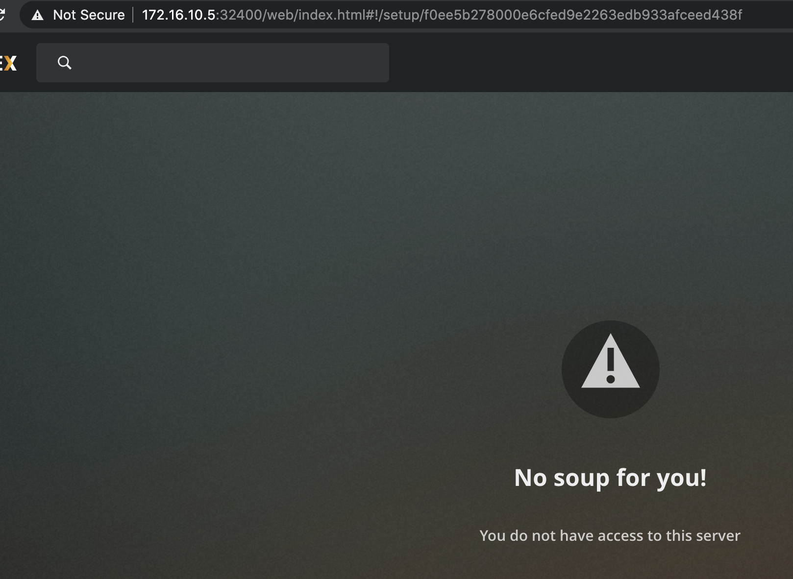

Hi all,
this problem I had started when I decided to upgrade from FreeNAS to TrueNas. Plex jail crashed, and I decided to go for a fresh plugin install.
After I installed the plugin, I got this message. I deleted the plugin and manually installed a jail + plex server on it—same result.
I suspect the PSM software to have some issues running on Jails because I did install it on a VM, and the server got recognized, and I can add local libraries.
I have open tickets on the plex community forum, but nobody is replying over there.
Any clue why this is happening?
TrueNas version : TrueNAS-12.0-U1.1
Jail version: 12.1-RELEASE
PSM version: 1.21.1.3830
thanks in advance

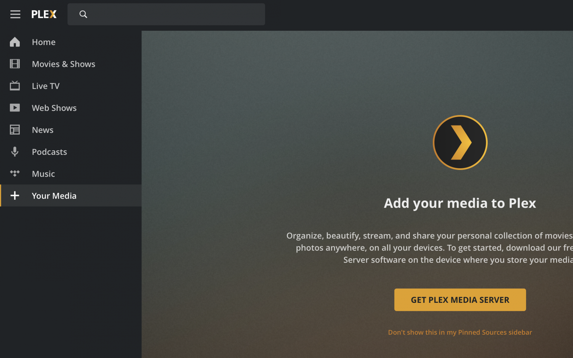

nikkon
Dec 16, 2012
171
thanks for replying. I just installed the PSM beta plugin. Same issue.
I also have a plex-pass account.
I've enabled the verbose more on PSM logs & the only errors I see in Plex\ Media\ Server/Logs/Plex\ Media\ Server.log
Jan 17, 2021 09:35:42.779 [0x80b785c00] ERROR - Error issuing curl_easy_perform(handle): 7
Jan 17, 2021 09:35:42.779 [0x80afea100] ERROR - Error issuing curl_easy_perform(handle): 7

G8One2
Jan 2, 2017
248
I run into this all the time. Always ends up being that I was not on the same network or subnet, as the jail.

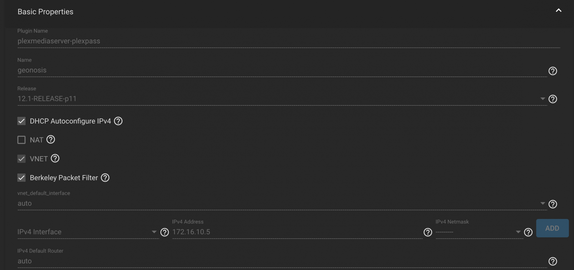

stualden
Apr 11, 2015
80
My suspicion would be the same as G8One2's. The address showing in your browser there looks strange - were you planning to use NAT on the jail? Easiest instead to set a static address for the jail that's on the same network as the rest of your setup, or (better) use DHCP and hand it a fixed lease.

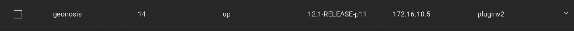

let me show you how is configured:
Lan network is 172.16.10.0/24

stualden
Apr 11, 2015
80
Hmm - network settings look right, so it's something else. Are all the various Plex processes running? Compare against what I see here (I tried ps -Ao user,command -U plex):
