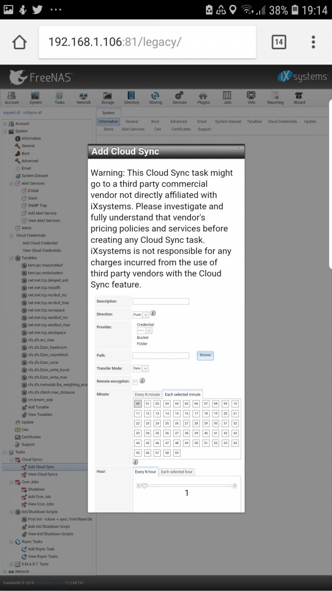

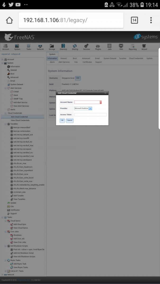

Yes but I want to use the inbuilt with in the Gui.

Right. And to do that, you need the token that comes from doing what I mentioned.

I can now confirm that I have used the method I mention above to produce the token and used it with success to create a sync (in the GUI) from FreeNAS 11.2 Beta1 to Onedrive personal.
All of the command line interactions with rclone are clear and relatively easy to read. the token is a big one, but it's clear where it starts and ends (the curly braces need to be included in what you paste back from your browser-enabled machine).
