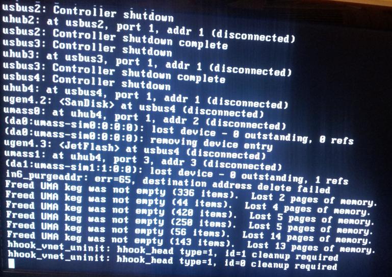

Here the screenshot :
I have to hard (power button) shutdown, eg the barbarian way :(
What's wrong (again).... ?

Looks like your flash drive with FreeNAS is being disconnected for some reason. Maybe try another port, or another flash drive.

Really ? I never had such issue with reboot (with long booting, yes). I'll try another port, or buy a new stick, I'll keep you inform.... But , please, look further on my screen, the both USB stick disconnect, aren't they (da0 is my freenas system, da1 , my jail)
Yes, I noticed the disconnect, but I missed that it was happening with both of your USB sticks. It might be an issue with your motherboard or BIOS. Maybe see if there's an update available for your BIOS?
Or the bad stick is causing the USB bus to reset, kicking both sticks off.
