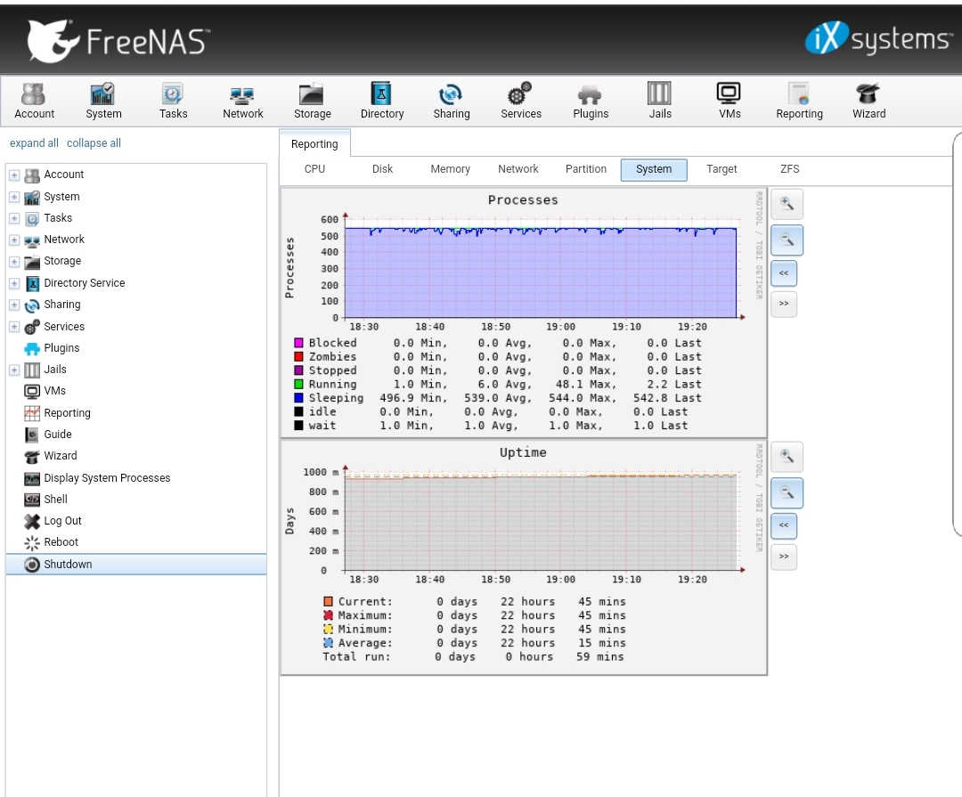

So insted of downgrading to 11.1 I upgraded to 11.2 U3. Created a new boot did a fresh install on a new USB drive. Put the USB in a different port then what I was using before. Reloaded my volume and uploaded my save config. System up and running last 22 hours with out any issue. Continue monitoring it now. Please I hope its fixes the issue. Finger crossed
