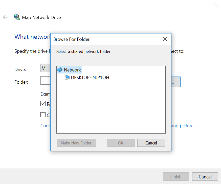

How am I suppose to map a drive, when it is not even showing? I can go to the IP, but that is just the NAS dashboard, I need to be able to manage the folders and add data from all my computers.
Also the Plex working, just meant the machine itself is on and working.

Instead of "Browse for a folder", you type \\ipoffreenas\
And poof, all your shares will show up in the drop down...or, if you know the name of the share, you can just put that in.
That's the big mystery of NetBIOS. Discovery sucks big-time, but name resolution actually works consistently.
