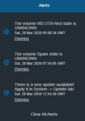

Current alerts:
* The volume WD-2TB-Red state is UNKNOWN:
* The volume Spare state is UNKNOWN:

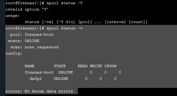

Can you share the output from zpool status -V ?

Here is the output:

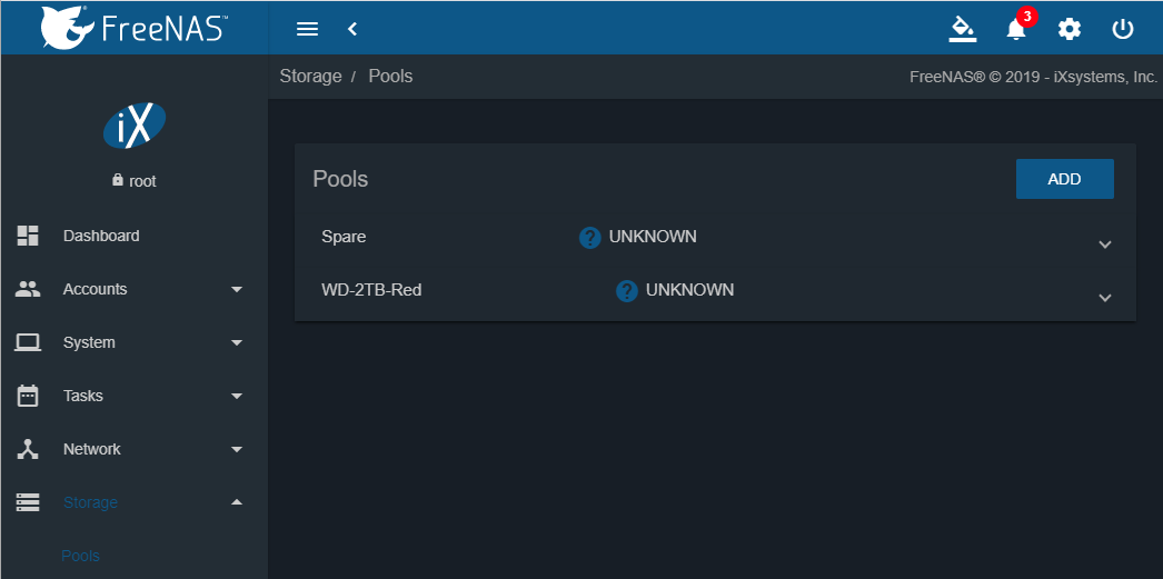

How are the pools "showing as unknown" - just in the alerts? Post a screenshot of Storage/Pools.

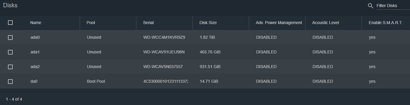

Here is a screenshot of the Disk Information

Hi, Yes they are all there. As the disks are showing up as per screenshot above. Also when the USB Drive crashed I got an alert email:
New alerts:
* Boot Pool Status Is ONLINE: One or more devices has experienced an unrecoverable error. An attempt was made to correct the error. Applications are unaffected.
This indicated to me that the problem is just with USB boot. I will confirm anyway that all HDD's are in bios.

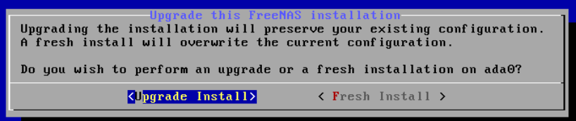

Now when looking through some older posts on here it mentions that I should select an upgrade option. Not a fresh install. In step 3 above there was no upgrade option available. Only new install. This is the window that should be made available to me.
System is now in a state where its running original FreeNAS-11.2-U4.1, saved configuration has been restored, but pools are still shown as being unavailable.
My next step to try is going to be doing an upgrade/install to a new release. Is this worth a shot?
