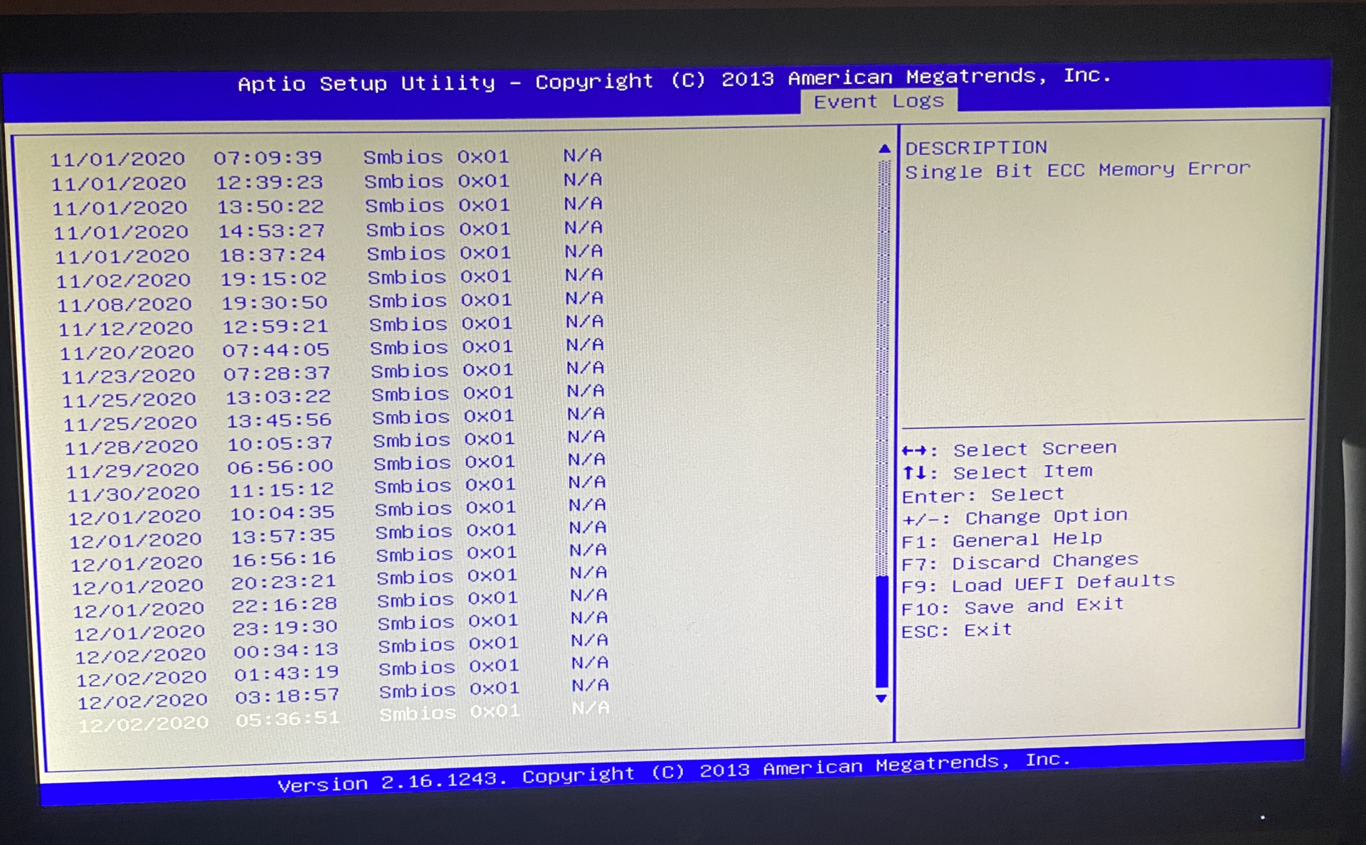

I've just looked at the bios event log and unfortunately it's not terribly helpful. It does show the events (labeled "Smbios 0x01" and described as "Single Bit ECC Memory Error"), but it doesn't give any more information beyond the date and time. In particular, it doesn't say anything about which module is causing the problem. Under the column labeled "Severity", which I've seen other interfaces apparently use to disclose the DIMM, it just says "N/A" (image attached).
I've also looked a bit more closely at the memory addresses reported in the MCA errors and cross referenced with dmidecode. If the addresses are to believed, about half the errors are coming from KBANK 0 DIMM0 (addresses 0 to 4294967295) and the other half from KBANK 1 DIMM0 (4294967296 to 8589934591). Is it possible I have *two* DIMMs that need replacing?

no_connection
Dec 15, 2013
480
That could be side one and two of DIMM0? Could be power issue on the module or slot. Just guessing here.
Herr_Merlin
Oct 25, 2019
200
some bios you need to reset the state of the dimm slot otherwise it won't check if the module is healthy again after replacement.
revengineer
Oct 27, 2019
193
Well checking the BIOS first was worth a try. Next you can check the procedure linked here to chase down the DIMM using dmidecode commands. For my Supermicro motherboard, this yielded inaccurate results, but you have nothing to loose trying. If this does not work you will have to remove them one by one and test the sticks using memtest86. The free version seems to detect ECC errors but you can not inject them (which you do not need). Memtest86 will also tell you how many modules are affected; I am not going to try to guess this from the addresses.
revengineer
Oct 27, 2019
193
Until excluded, I would go with the assumption that there is a single bad memory stick that needs replacing. I would not blame it on the slot especially if this worked in the past. When I first encountered the issue, someone stated that the memory controller on my CPU was bad, which it wasn't and which would have been a much more expensive fix. But the OP is at a point where he really just needs to start testing with memtest86 and swapping modules around to check the various failure modes.
