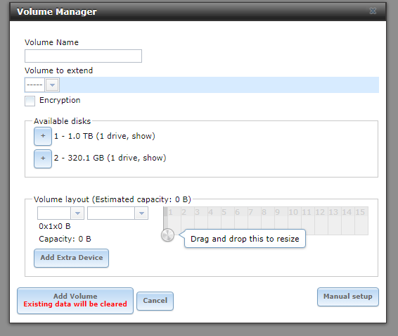

I have a rig with 2 x 1TB disks, and a 320Gb disk that I want to use to install FreeNAS on.
During the installation process, I double-triple check I install FreeNAS on the 320Gb disk.
However, after the installation, when I boot on the 25Gb drive, if I add a new volume, I only see 1 x 1TB disk and my 320Gb drive as available.
Since I cannot share the disk FreeNAS is installed on, I guess it's because FreeNAS is installed on my other 1TB drive.
So the target I specified during the install is not respected.
Has this ever happened to anyone ? Am I misreading the configuration menu ?

Okay, I just tried, and there is some evidence I had two different installation of FreeNAS on different drives. For some reason, I cannot get the machine to boot on the 320Gb drive, even if I disable every other option and only leave this one.
It will keep on booting on the 1Tb drive installation unless I unplug it.
I don't know if it's the drive or the MB (or FreeNAS), but the drives don't seem to be hot swappable, so I'm forced to remove the evil drive and format it elsewhere, then plug it back. Unless there's a trick ?
