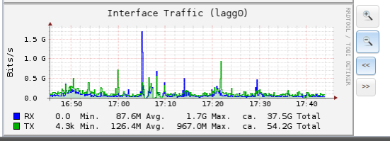

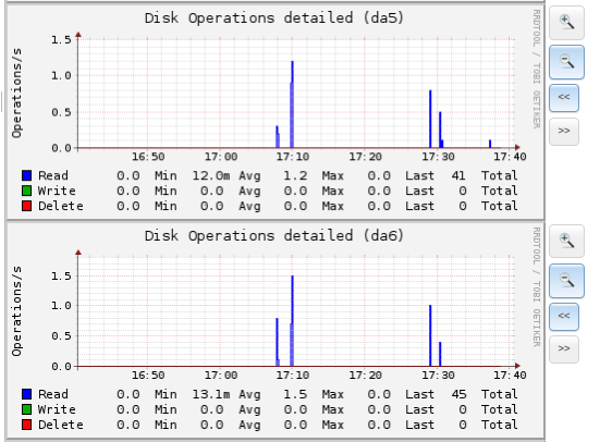

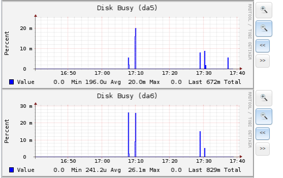

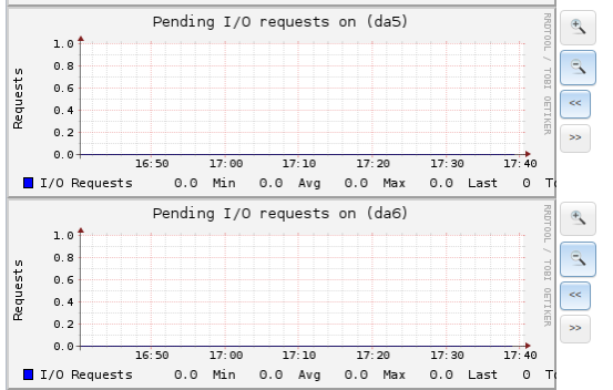

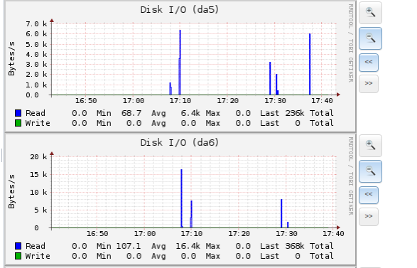

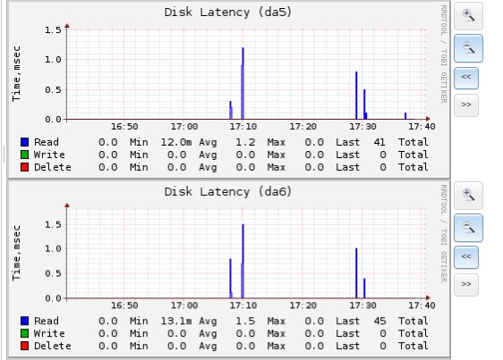

I'm seeing that freenas is getting hung for a few minutes (1-5min) sporadically
checking the graphs, I can see a big disk activity on the OS disk, causing a large IO busy
I attached some pictures that describe this peak activity
How can I debug this in order to understand what is the cause for this spike in disk activity?
