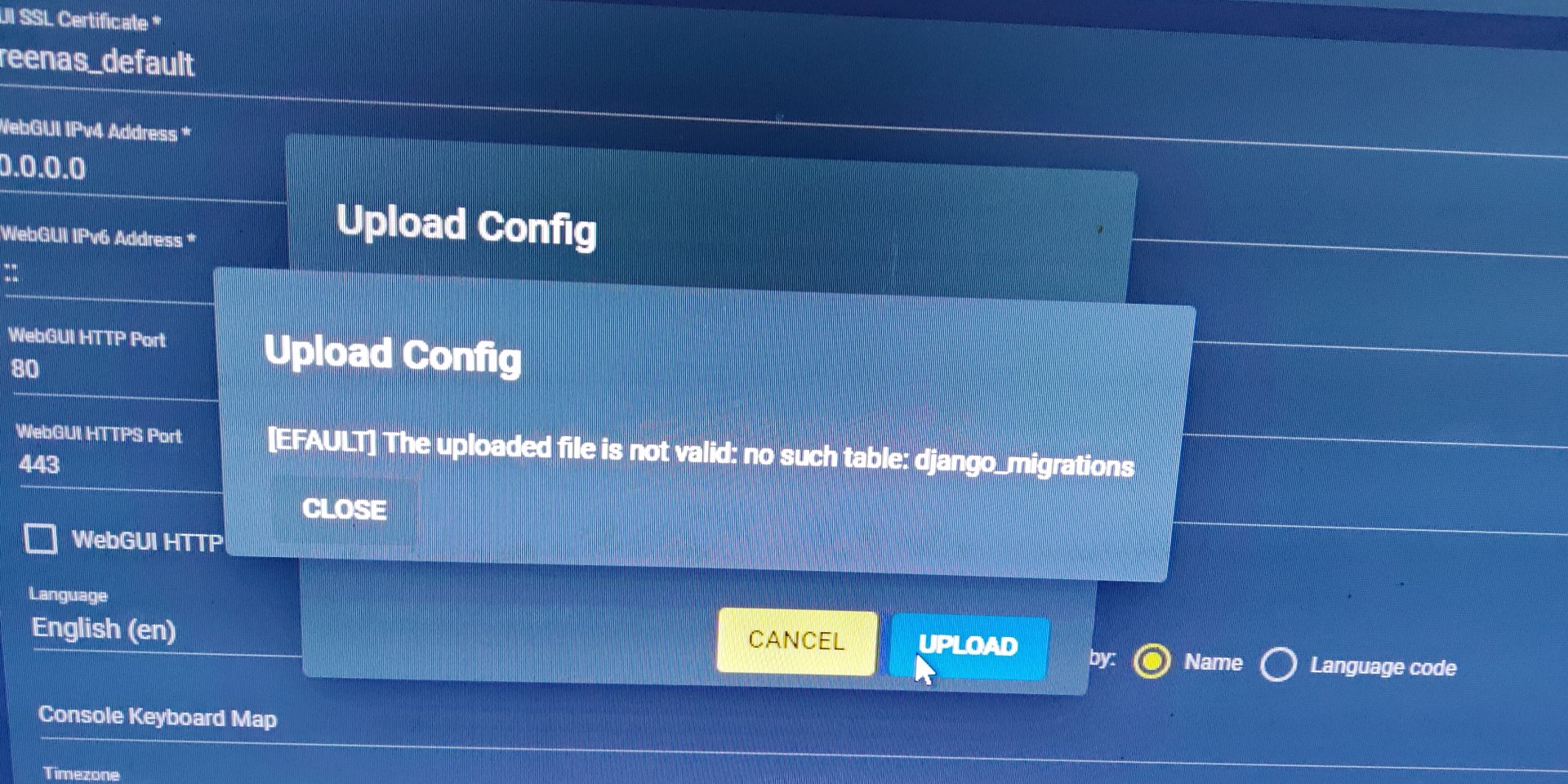

I had 9.3 since I made the server, and my usb got fried, so I've decided to do a fresh install of the new update 11.3 into a SSD. After installation, several issues:
1. I'm not able to pull the old config from the usb drive, I did save the config, but whenever I tried to upload the config. I kept getting an error message " [EFAULT] The uploaded file is not vali: no such table: django_migrations".

I think you will have to follow the upgrade path through the different versions to update the config DB for each change.

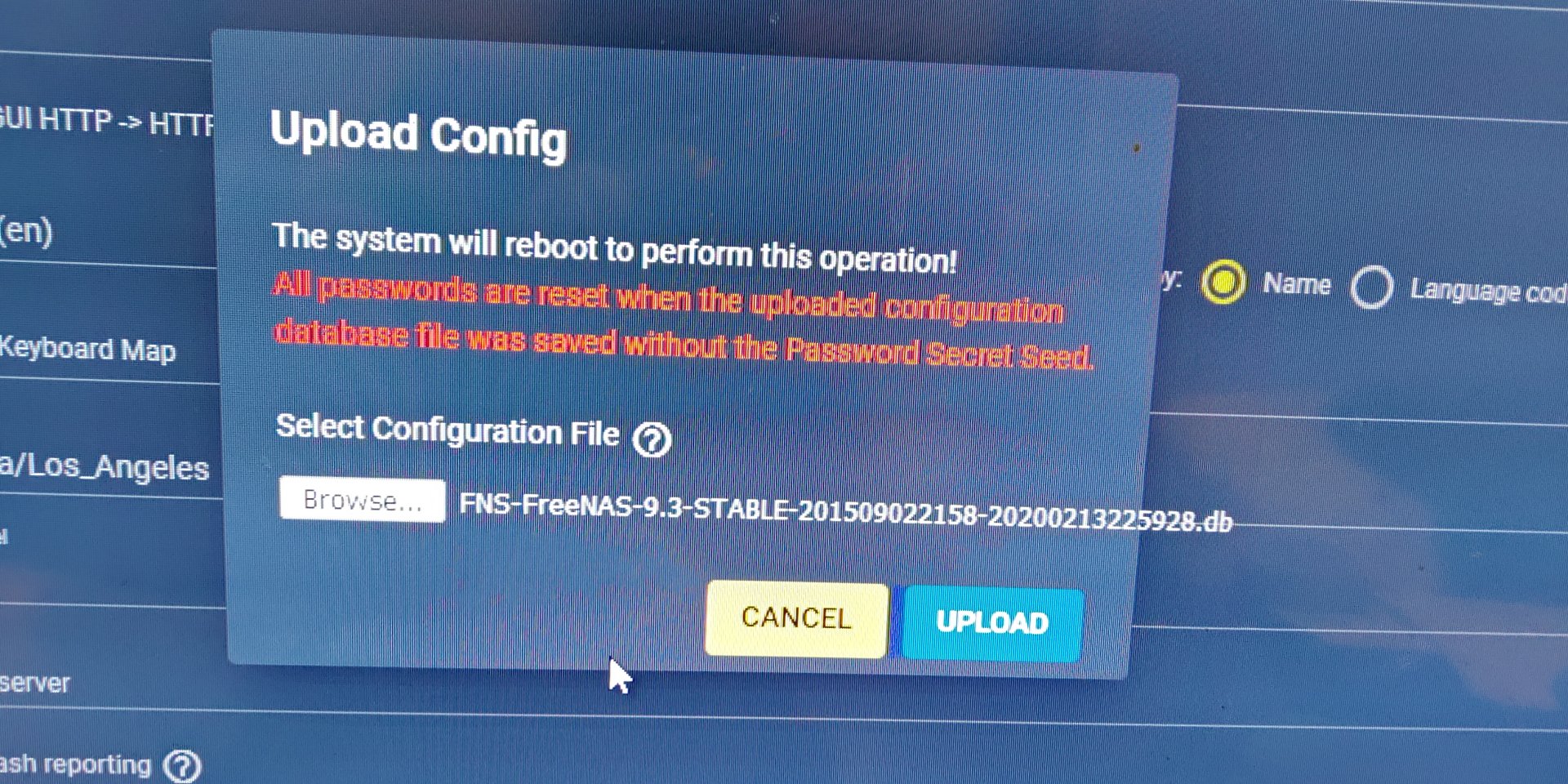

Feb 19, 2020
My guess : you should have installed 9.3, upload the config file then import the failing pool.
Okay I did that and reinstall the 9.3, now I have the same with viewing disk. The system says one of my HDD is degrading, but it's not showing on the list of disk. is that mean, I just need to search for the HDD that is NOT on the list and that's the one that needs to be replace?

CLI maybe more useful :
zpool status -v
camcontrol devlist
Search the forum for more insight.
