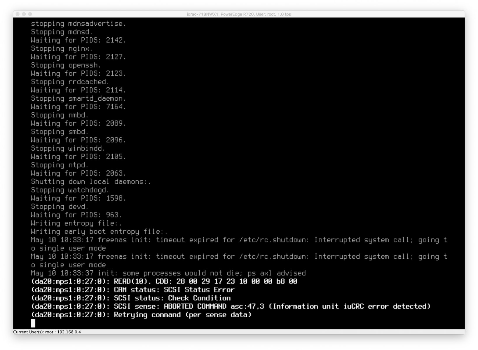

Hi. I have a problem with FreeNAS hanging at shutdown (I'm using the GUI to initiate Shutdown). Here's the output:
Writing Entropy file:.
Writing early boot entropy file:.
<date> freenas init: timeout expired for /etc/rc.shutdown: Interrupted system call; going to single user mode
<date> init: some processes would not die; ps axl advised
And then it just halts here until I power off the server.
I don't really know how to fix it or even check the system for corruption etc. I did a scrub on the boot USB and that came back OK.
The boot USB stick is mirrored to an identical one, and I've also saved the config to another machine for safety.

Which processes aren't dying? What does ps axl show you?
atlantic
Jan 9, 2020
52
Hi Yorick. I don't know which are not dying, and I don't know what ps axl is. Here's a grab of the output (the SCSI errors are due a drive that needed reseating which I think is fixed, not related to the shutdown issue IIUC).

ok did some digging, and ‘ps axl advised’ is telling me to try process spy, which i have used before but wasnt aware i could still interact with the server while it is hung like that. It doesnt respond via usb keyboard or via idrac.
Can i ssh in and use ps to find the errant process and kill via its pid?
