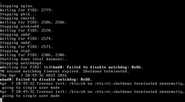

hey guys,
First time user, running FreeNAS-9.10-STABLE-201603252134 on the following system:
CPU: Intel Xeon E3 1231 v3
Motherboard: Supermicro X10SL7-F
RAM: 2 x Crucial 16GB Kit DDR3-1600 ECC UDIMM
HDD: 8 x 4 TB HGST Deskstar NAS Drive (in raidz2)
Flash Storage: InnoDisk 16GB SATADOM-MV 3ME
During each and every system reboot or shutdown, I'm getting the following console entries (also see attachment):
Shutting down local daemons:.
Stopping watchdogd.
wWaiting for PIDS: 1636bwd0: Failed to disable watchdog: 0x86.
90 second watchdog timeout expired.  Shutdown terminated.
wbwd0: Failed to disable watchdog: 0x88.
... freenas init: /bin/sh on /etc/rc.shutdown terminated abnormally,
 going to single user mode
I've considered tweeking system parameters rcshutdown_timeout and kern.init_shutdown_timeout in Tuneables but this doesn't make much sense given that I'm not (yet) running any jails or plug-ins.
Supermicro watchdog has been disabled; in BIOS and JWD1 set to open (disabled).
What can I do to get a normal system reboot / shutdown?
Thanks.

Interesting (sounds like a hardware/BIOS something). Anything else in /var/log/messages?

I'm also a first time user with NO previous FreeBSD knowledge and almost identical hardware to the OP.
Motherboard: Supermicro X10SL7-F (Latest Bios 3.oa)
RAM: 4 x Crucial 8GB DDR3-1600 ECC UDIMM
2 x 8Gb Sandisk Cruzer Force
Latest version of Freenas 9.10 installed to USB sticks. No HDDs attached yet. Tried both Watchdog settings in BIOS. Same error on shutdown
bwd0: Failed to disable watchdog: 0x87 ....(waits just over a minute)
wbwd0: Failed to disable watchdog: 0x86 .... then shuts down, stating abnormal termination.
