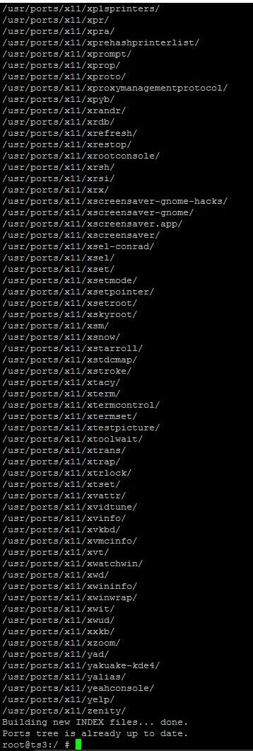

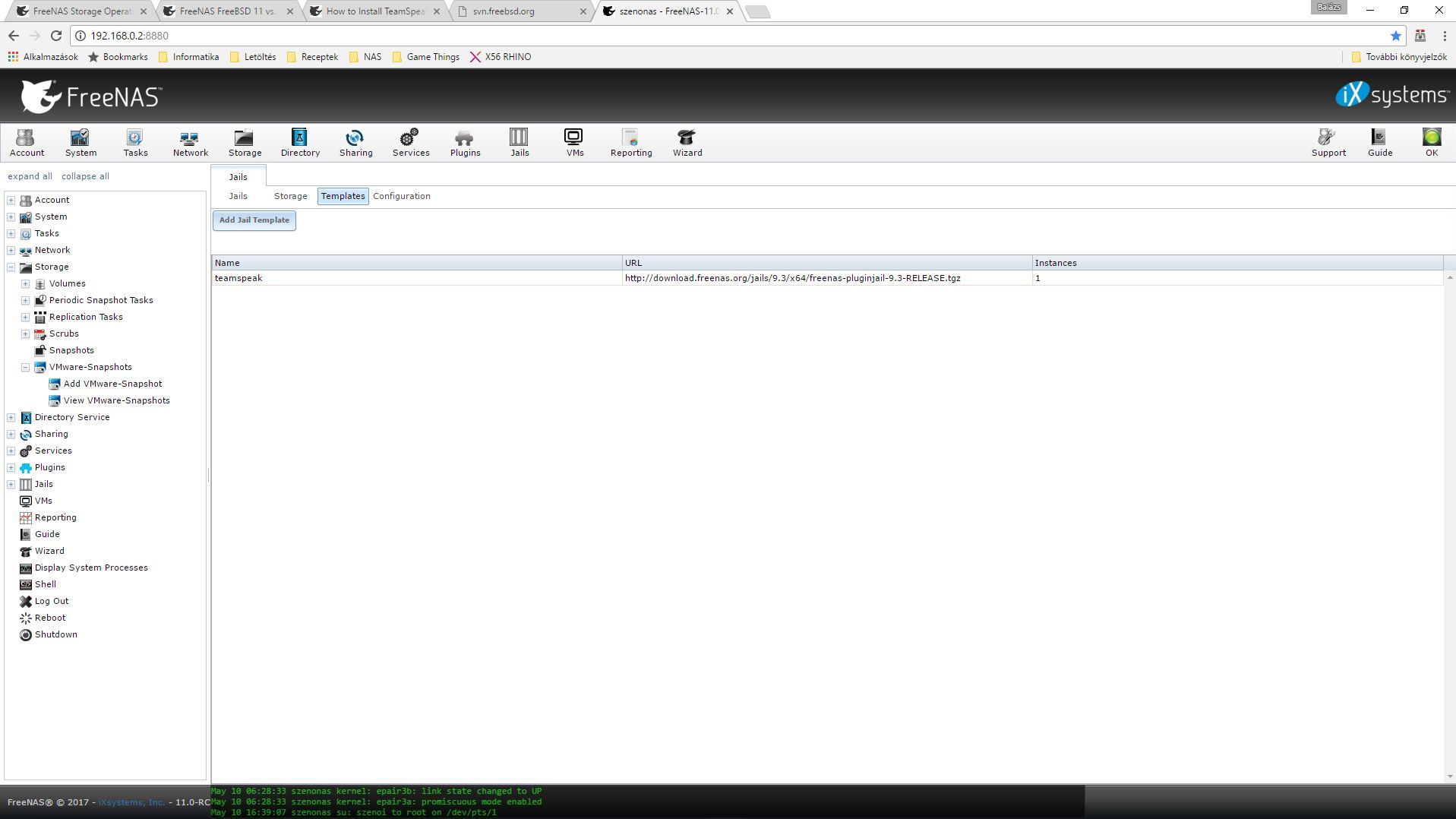

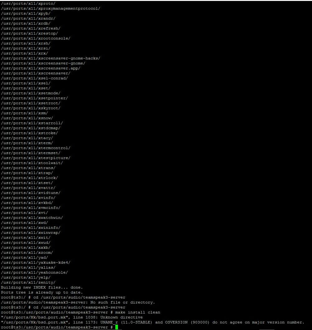

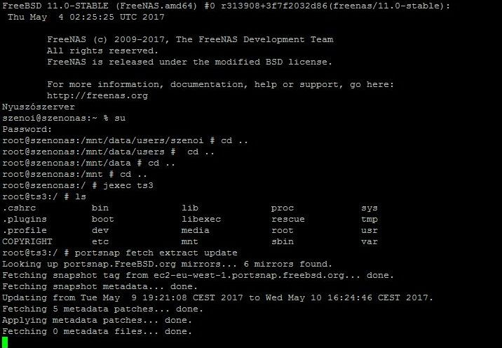

Hey!
Thanks the help :smile:
I saw this post with the installation guide, but it cant help me.
I made some screenshots from my installation procedure, and the error message at the end of pocedure.
I did create a template for the jail, and i tried to install the ts3 server into it.
Any idea what i did wrong?

It appears that it doesn't like that you're using FreeNAS 11, Unless there's a way to tell it to ignore that and continue, you might have to downgrade.. I'd look around for that error (Surely, someone else got it too) and might have a workaround.
SweetAndLow
Sweet'NASty
Nov 6, 2013
6,421
Skip that template stuff you will not get it to work.
It looks like you have a freebsd 9.3 jail and are trying to install a freebsd 11 port. Can you create a brand new jail and try again?
Szenoi1977
Jul 17, 2013
10
Yes, i can make a new jail, but when i make this instance, surpriselly it was a freebsd 11... i dont understand how. So i make a jail again, and what i need to do?
