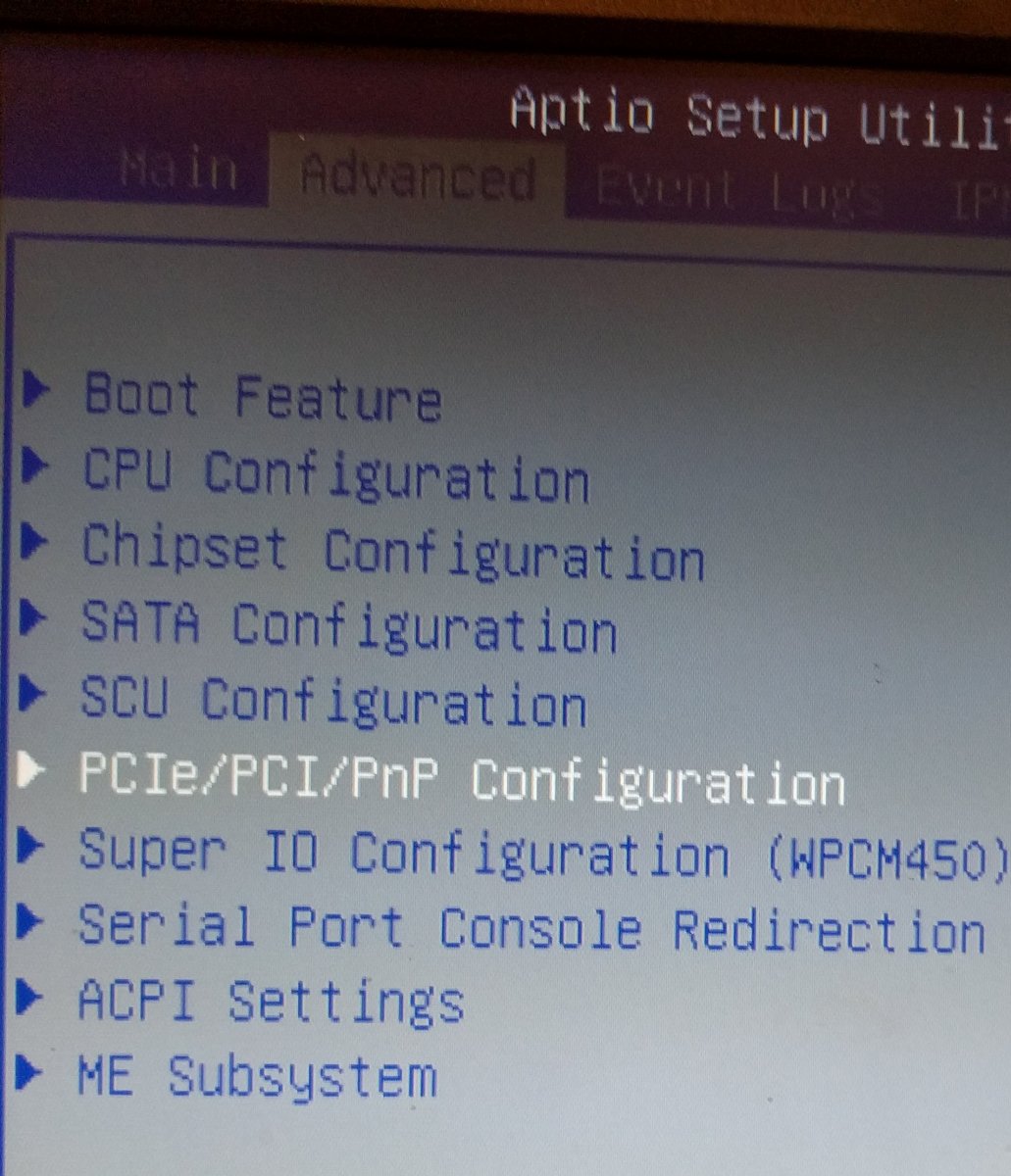

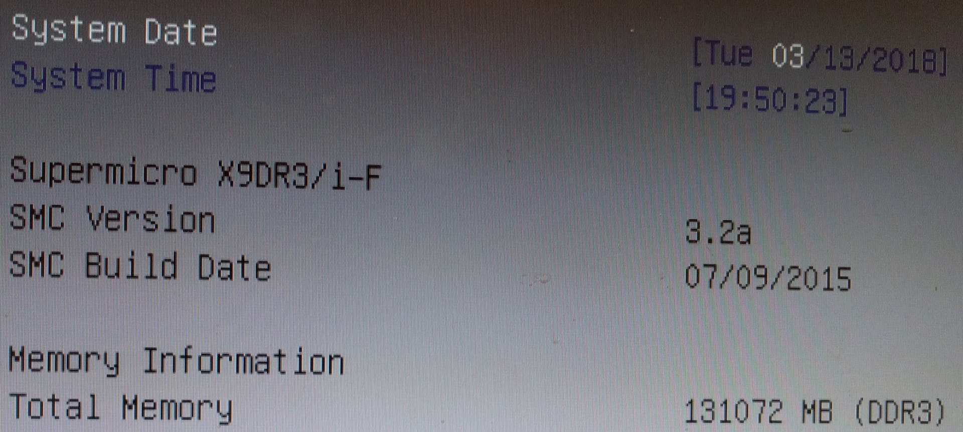

So I got ESXI 6.5 running on it. It was indeed the wrong boot order - it had the SATA DOM first. I ordered a PWM splitter and a set of 5 PWM extensions from Newegg for cheap then later found out that the Noctua NH-U9DXi4 came with splitters - doh! I looked through the BIOS and made sure the settings all looked good, but I oddly could not find anything about the fans or other "thermal management" as mentioned in the Mobo manual. Below are a few pictures. I know there may be some updating to do of the BIOS.
- Penguin Computing Icebreaker?
-- no Thermal Management option here

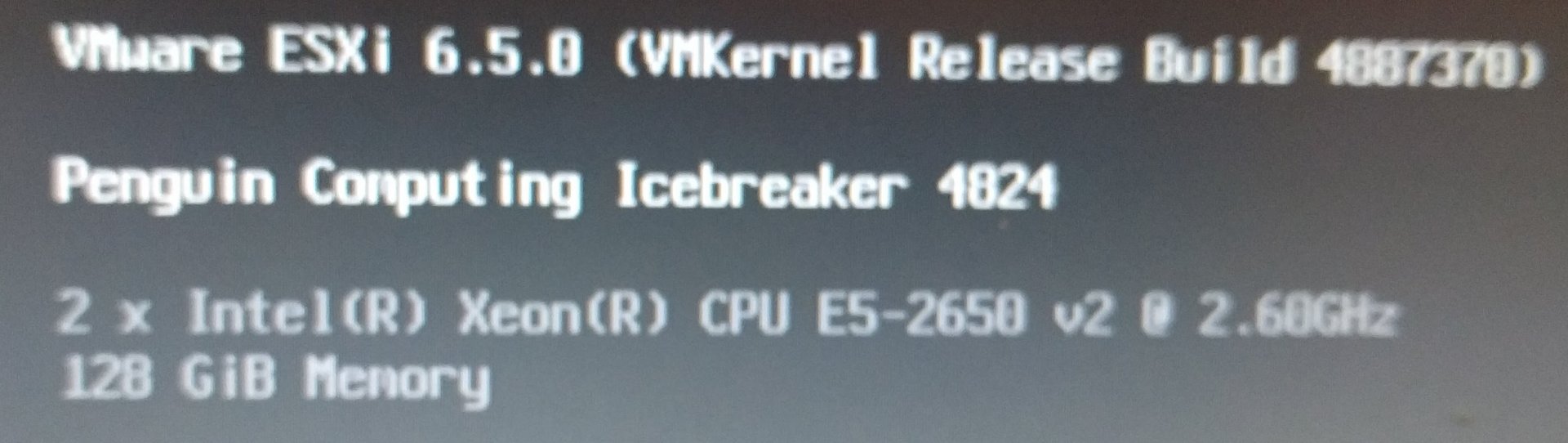

I went ahead and used the 4 Noctua 4-pin noise reducers and one 3-pin noise reducer that I bought from Chris's suggestion. Is there any difference between the 3 and 4pin noise reduction/undervolting/resistor wires, especially if I can't even find a way to control the PWNness? That question barely makes sense to me. Why even have a PWM undervolting/resistor wire unless you can somehow turn the undervolting off when PWM is accessible? Is it only controllable by the awesomely retro SuperDoctor application?
Also, what gives with "Penguin Computing, Icrebreaker ###"? Is this board a fraud or just rebranded?
The good thing is, despite all of this, and the rails taking yet another day. I am now able to test the energy usage of the machine while being able to start getting the VMs and FreeNAS going.
The beast is alive!
The FAN settings are only accessible in the IPMI interface AFAIK.
Will be playing with that today hopefully. Good to know.

I looked at their website too, but I was sold a SuperMicro board. I just was caught a little off guard by the different make and model. I wonder if they are a company that takes old equipment, fixes it up, and sells it under a different name. I hope I am not losing out on the quality of the SM product line. That is the entire reason I went for the combo deal. I don't mind the change in name as long as the quality underneath is the same. Ahh, just read up on what "whitebox"ing is. That may be the case. No biggie if so, just unexpected.
They (Penguin Computing) bought the Supermicro system when it was new, customized it and sold it as their own product. Kind of like a company that buys a Ford truck body and puts a camper on it, then sells it as a motor home.
I'm not a morning person ... I was hoping the dots would connect themselves as the caffeine hadn't quite kicked in yet :)
http://www.supermicro.com/wheretobuy/namerica.cfm?rgn=101 (cell C3)
Its Supermicro ... can't you do a little better than Ford in your analogy? :) [Not that there is anything wrong with Fords]

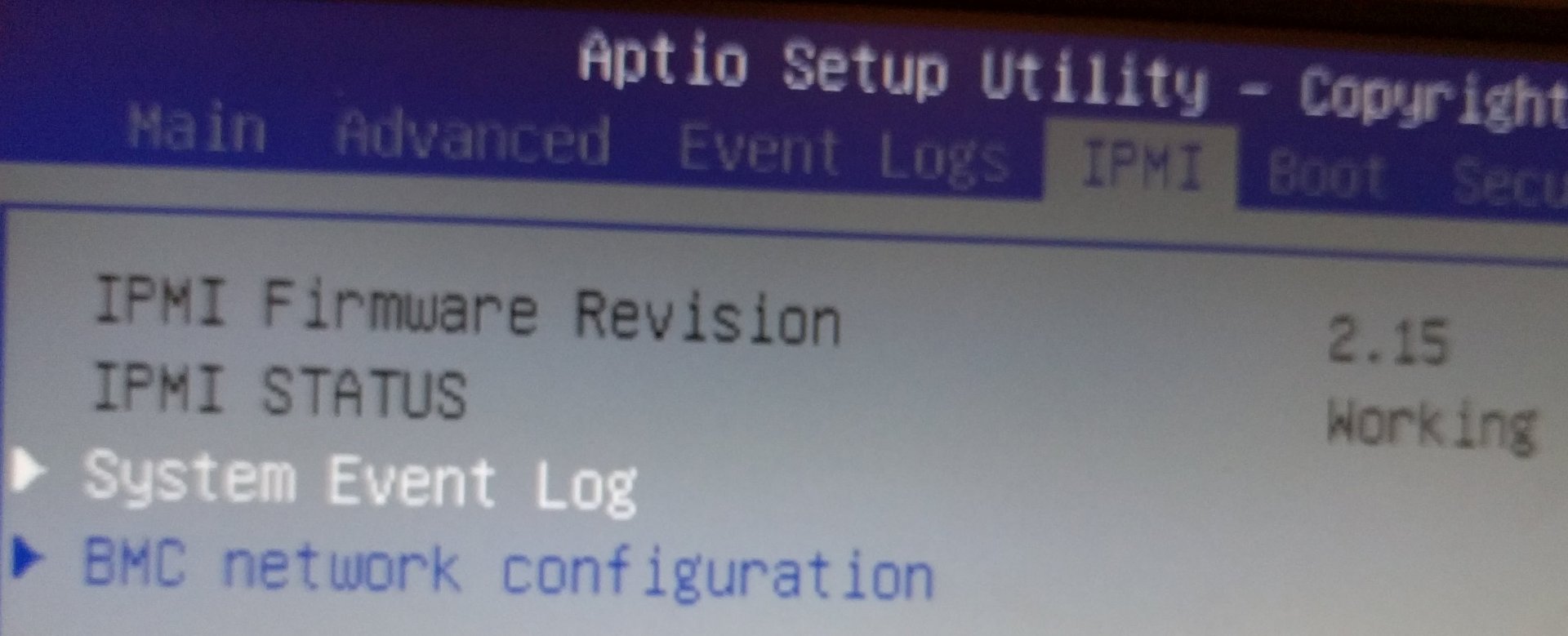

Looks like the IPMI does not work while using only one Ethernet interface. This is not a shocker, but wanted to try it anyway (using a VM to connect to the hardware below). I am going to try to install the SuperDoctor software on a Window's VM, but am saddened that it only supports SuSe and RedHat Enterprise Linux Distros. I assume it would work on Fedora/CentOS, but I had hoped to use Debian for my server's(') distro. I wanted to wait before using one of the Cisco switches as I only have one Ethernet cable coming into the lab. I only have one H110 for remote outlet control, so the only way I could control both the switch and the server with it is putting it between the surge protector (could do) or UPS (not exactly how its meant to be used).
Good testing so far, much to come. I won't update this post too often until I have something good or issues arise. I am working my way up the layers from hardware, BIOS, IPMI, ESXI (rights, VM setup), then finally to FreeNAS for home storage/backup/media serving use. The rest of the lab and VMs are not as relevant to this community, so I will only keep to the highlights on those.
Sure it does, assuming you're using the correct port.
svtkobra7
Jan 12, 2017
202

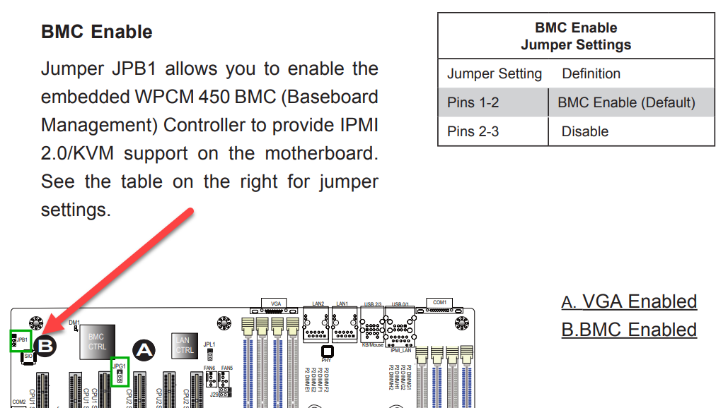

Correctamundo (with one caveat, correct port and correct IP address for the IPMI interface). Edit: OK, technically 3 caveats, the JPB1 jumper needs to be set correctly (2-35 in your manual).

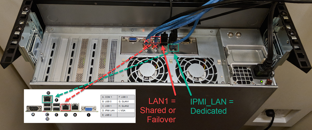

You have three options for which port IPMI uses and you must connect your interfaces accordingly. I thought you had the same motherboard as I so I annotated a picture of the rear of my server, but then I realized yours is a X9DRi-F so I dropped in the diagram from that board's quick reference guide. The design is similar, on both, it is the network interface above the USB ports.
  • Dedicated: Always use dedicated IPMI interface.
  • Shared: Always use LAN1 interface.
  • Failover: If dectected on IPMI, then use IPMI, otherwise fall back to LAN1.
[ I don't think the manual goes into much detail on this but didn't check ]
So to Eric's point, if you haven't changed the BIOS setting, and you have an Ethernet cable connected to the IPMI interface = it works. Double check that. Also, set it to a static IP on your network.
I couldn't live without IPMI (well, I could probably live, but not happily). To @Chris Moore 's prior comment, I agree it should be on a separate network once you get everything configured and to that end, I'd recommend using the Dedicated setting mentioned above. Some go as far as to disconnect it when not in use; however, I think that may be a little too cautious / overkill. And make sure you change the default admin/admin username/password.
How do you have it connected and what do your IPMI BIOS settings look like?
Edit: Here is the link to SuperMicro's IPMIView (not sure if you found it or were guided to it yet): ftp://ftp.supermicro.com/utility/IPMIView/
