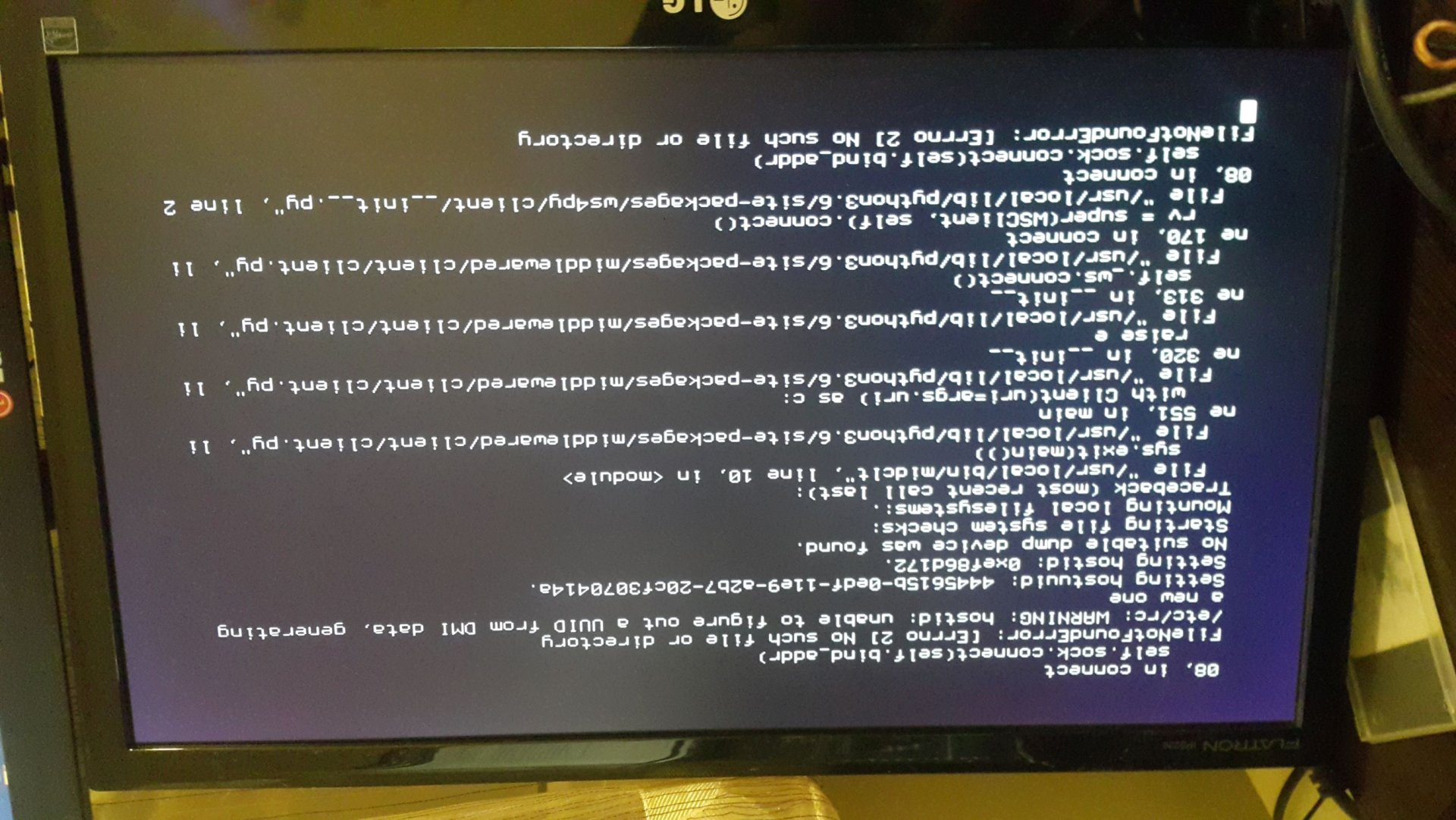

i install freenas on external usb flash drive ,and install completed with no error.
after restart when it boots,the error in attached file appears.
whats this?

release 11.2u1.i use cdrom as boot device and usb for freenas storage.i install it without error.when it boot this error appears.
hardware spec: MB:sabertooth x58,CPU ci7 920 ,18GB RAM,no hdd yet installed
mafrooz
Jan 2, 2019
4
i format the usb by gparted. and create another usb freenas installation boot with rufus.and install free nas again.its ok..no problem exist more.
i was installed freenas 3 times with cdrom boot disk and it had same problem,i don't know for what reason.
If you would, please file a bug report on this. It is probably something simple that was done wrong when the ISO file was created. The developers need to look at it to see.
