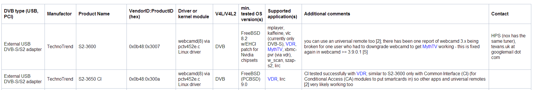

Here is the tuner card we plan to use:
http://www.technotrend.eu/2715/TT-connect__S2-3650_CI.html
https://wiki.freebsd.org/WebcamCompat
It seems to appear in this list so is there any hope since FreeNAS is based on freebsd I guess.?

diedrichg
Dec 4, 2012
1,319
I believe that is the case, yes - as long as it was supported in FreeBSD 9 then it is in the current builds of FreeNAS.
