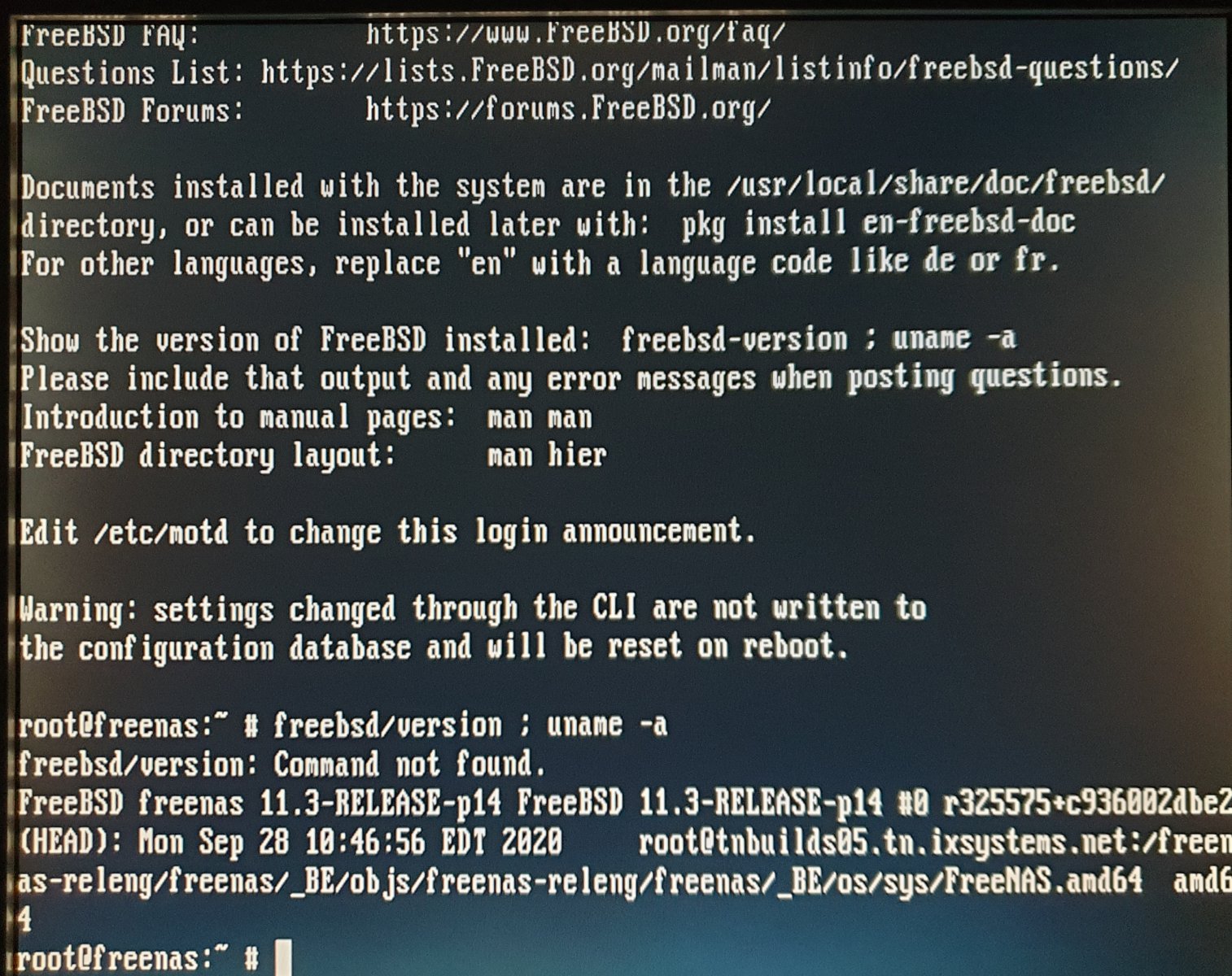

Since this moment i cannot successfully boot my FreeNas-Server (no access over gui, server not listed in network), and everything shown on the screen (directly atteched to the server) is some information about "FreeBSD":

Sooo...
maybe i am a little bit unpatient and maybe this also caused my "problem" (coupled with one missing information)...
First unpatience: i didn't wait for any reply and tried a fresh install on my own (TrueNas 12.0 U7) three days ago.
Second unpatience: after finally successfully installing TrueNas (first try with wrong UEFI settings) i got the same screen shown on the monitor as you can see in my first post.
missing information: i found out, that this screen is shown if i insert login-name ("root") at the point of the boot where i get asked for it. But it seems that this is not needed, even more if i don't insert anything and wait long enough, the server boots as it should...
So it's possible my initial problem was only because i did what i was asked on the screen during boot session...
