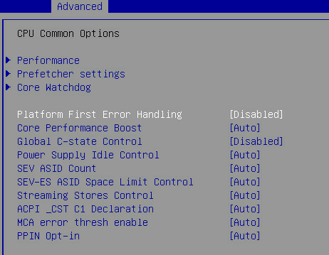

PFEH setting in BIOS

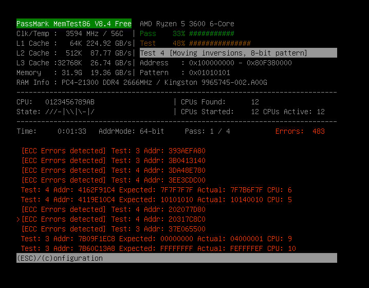

Screenshot taken after 1m33sec with memory overclocked / undervolted

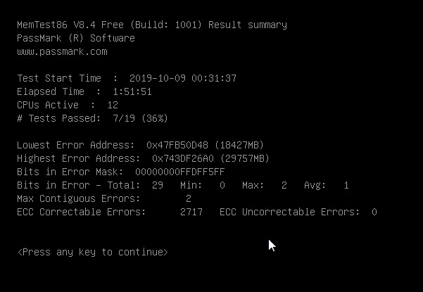

screenshot after almost 2h after ending the run with memory overclocked / undervolted:

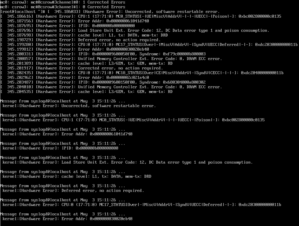

3rd working method
This is how Asrock Rack and AMD tested it:
The BIOS
Everything default except
  • "Platform First Error Handling" was changed from the default "Enabled" to "Disabled"

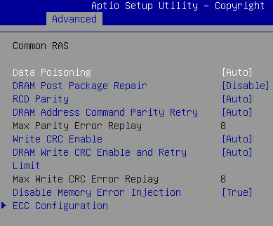

  • "Disable Memory Error Injection", strangely enough, was (accidently) set to the default "True". I think Asrock Rack fell for their own double negation confusion ;) I haven't tried it yet with set to false. I also haven't retried Memtest86 error injection with these settings again...
The OS
I used a fresh install of "Fedora-Server-dvd-x86_64-32-1.6.iso" for this. I might have selected a few additional package groups during the install, not sure if it will make a difference to the below instructions.

  3. (Corrected) single-bit ECC memory error detection by "the OS" works (if correctly implemented)!
    • Already confirmed / proven earlier in this thread.
    • But only when setting "Platform First Error Handling" to disabled in the BIOS.
    • Works on for example
      • Memtest86 v8.4 or higher
      • Linux kernel 5.6 or higher
      • TrueNAS 12.0 beta 1 (not on FreeNAS 11.3)
  4. (Uncorrected) multi-bit ECC memory error detection by "the OS" works (if correctly implemented)!
    • This is a new discovery.
      • Memtest86 (unreleased version - fixes will be included in next release)
      • Linux kernel 5.7 (probably also on 5.6, but I didn't try it)
      • Not sure about TrueNAS 12.0 beta 1. I haven't been able to trigger or recognize it yet.
  5. IPMI / BMC is unable to detect any kind of memory error
    • Confirmed once more.
    • Even when setting "Platform First Error Handling" to enabled in the BIOS.
    • Asrock Rack is (hopefully) still working on getting this fixed?
Memtest86
After notifying Passmark that Linux is able to detect (uncorrected) multi-bit ECC memory errors and Memtest86 v8.4 isn't, they've asked me to send the log files. They then provided me a new version (so far still unreleased) which fixes the issue and can properly detect (uncorrected) multi-bit ECC memory errors!
Sorry, forgot to take a screenshot of this one. I do still have the log file. Here is the summary of the report:
Test Start Time2020-05-25 08:19:11
Elapsed Time1:47:46
Memory Range Tested0x0 - 80F380000 (33011MB)
CPU Selection ModeParallel (All CPUs)
ECC PollingEnabled
# Tests Passed7/19 (36%)
Lowest Error Address0x489128C48 (18577MB)
Highest Error Address0x73D8367A0 (29656MB)
Bits in Error Mask00000000FDDFFFFF
Bits in Error30
Max Contiguous Errors2
ECC Correctable Errors2689
ECC Uncorrectable Errors244
Linux
Maybe I have triggered these earlier already, but I didn't notice them till recently.
[root@localhost ~]# edac-util -v
mc0: 0 Uncorrected Errors with no DIMM info
mc0: 0 Corrected Errors with no DIMM info
mc0: csrow2: 0 Uncorrected Errors
mc0: csrow2: mc#0csrow#2channel#0: 0 Corrected Errors
mc0: csrow2: mc#0csrow#2channel#1: 3 Corrected Errors
mc0: csrow3: 1 Uncorrected Errors
mc0: csrow3: mc#0csrow#3channel#0: 3 Corrected Errors
mc0: csrow3: mc#0csrow#3channel#1: 0 Corrected Errors
[root@localhost ~]# ras-mc-ctl --summary
Memory controller events summary:
Corrected on DIMM Label(s): 'mc#0csrow#2channel#1' location: 0:2:1:-1 errors: 3
Corrected on DIMM Label(s): 'mc#0csrow#3channel#0' location: 0:3:0:-1 errors: 3
Fatal on DIMM Label(s): 'mc#0csrow#3channel#0' location: 0:3:0:-1 errors: 1
No PCIe AER errors.
No Extlog errors.
No devlink errors.
Disk errors summary:
0:0 has 17 errors
0:2048 has 147 errors
0:2816 has 4 errors
MCE records summary:
12 Corrected error, no action required. errors
1 Deferred error, no action required. errors
2 Uncorrected, software containable error. errors
[root@localhost ~]#
[root@localhost ~]# cat /var/log/messages
May 20 00:08:59 localhost rasdaemon[995]: rasdaemon: mce_record store: 0x55aaea8a19e8
May 20 00:08:59 localhost kernel: mce_notify_irq: 1 callbacks suppressed
May 20 00:08:59 localhost kernel: mce: [Hardware Error]: Machine check events logged
May 20 00:08:59 localhost kernel: [Hardware Error]: Corrected error, no action required.
May 20 00:08:59 localhost kernel: [Hardware Error]: CPU:0 (17:71:0) MC17_STATUS[Over|CE|MiscV|AddrV|-|-|SyndV|CECC|-|-|-]: 0xdc2040000000011b
May 20 00:08:59 localhost kernel: [Hardware Error]: Error Addr: 0x00000003080ccb40
May 20 00:08:59 localhost kernel: [Hardware Error]: IPID: 0x0000009600050f00, Syndrome: 0xf79c00000b800003
May 20 00:08:59 localhost kernel: [Hardware Error]: Unified Memory Controller Ext. Error Code: 0, DRAM ECC error.
May 20 00:08:59 localhost kernel: EDAC MC0: 1 CE Cannot decode normalized address on mc#0csrow#3channel#0 (csrow:3 channel:0 page:0x0 offset:0x0 grain:64 syndrome:0x0)
May 20 00:08:59 localhost kernel: [Hardware Error]: cache level: L3/GEN, tx: GEN, mem-tx: RD
May 20 00:08:59 localhost kernel: [Hardware Error]: CPU:0 (17:71:0) MC18_STATUS[Over|CE|MiscV|AddrV|-|-|SyndV|CECC|-|-|-]: 0xdc2040000000011b
May 20 00:08:59 localhost kernel: [Hardware Error]: Error Addr: 0x00000003095cc100
May 20 00:08:59 localhost kernel: [Hardware Error]: IPID: 0x0000009600150f00, Syndrome: 0x510600800a800302
May 20 00:08:59 localhost kernel: EDAC MC0: 1 CE Cannot decode normalized address on mc#0csrow#2channel#1 (csrow:2 channel:1 page:0x0 offset:0x0 grain:64 syndrome:0x80)
May 20 00:08:59 localhost rasdaemon[995]: rasdaemon: register inserted at db
May 20 00:08:59 localhost rasdaemon[995]:           <...>-661   [000]     0.000066: mce_record:           2020-04-01 19:34:33 +0200 Unified Memory Controller (bank=17), status= dc2040000000011b, Corrected error, no action required., mci=Error_overflow CECC, mca= DRAM ECC error.
May 20 00:08:59 localhost rasdaemon[995]: Memory Error 'mem-tx: generic read, tx: generic, level: L3/generic', memory_channel=0,csrow=3, cpu_type= AMD Family 17h Zen1, cpu= 0, socketid= 0, misc= d01a0f7c01000000, addr= 3080ccb40, synd= f79c00000b800003, ipid= 9600050f00, mcgstatus=0, mcgcap= 11c, apicid= 0
May 20 00:08:59 localhost rasdaemon[995]: rasdaemon: mc_event store: 0x55aaea8a4418
May 20 00:08:59 localhost rasdaemon[995]:           <...>-661   [000]     0.000066: mc_event:             2020-04-01 19:34:33 +0200 1 Corrected error: Cannot decode normalized address on mc#0csrow#3channel#0 (mc: 0 location: 3:0 grain: 6)
May 20 00:08:59 localhost rasdaemon[995]:           <...>-661   [000]     0.000066: mce_record:           2020-04-01 19:34:33 +0200 Unified Memory Controller (bank=18), status= dc2040000000011b, Corrected error, no action required., mci=Error_overflow CECC, mca= DRAM ECC error.
May 20 00:08:59 localhost rasdaemon[995]: Memory Error 'mem-tx: generic read, tx: generic, level: L3/generic', memory_channel=1,csrow=2, cpu_type= AMD Family 17h Zen1, cpu= 0, socketid= 0, misc= d01a01d301000000, addr= 3095cc100, synd= 510600800a800302, ipid= 9600150f00, mcgstatus=0, mcgcap= 11c, apicid= 0
May 20 00:08:59 localhost rasdaemon[995]:           <...>-661   [000]     0.000066: mc_event:             2020-04-01 19:34:33 +0200 1 Corrected error: Cannot decode normalized address on mc#0csrow#2channel#1 (mc: 0 location: 2:1 grain: 6 syndrome: 0x00000080)
May 20 00:08:59 localhost abrt-server[1611]: Not saving repeating crash in '/boot/vmlinuz-5.6.8-300.fc32.x86_64'
May 20 00:08:59 localhost abrt-server[1614]: Not saving repeating crash in '/boot/vmlinuz-5.6.8-300.fc32.x86_64'
May 20 00:08:59 localhost abrt-server[1618]: Not saving repeating crash in '/boot/vmlinuz-5.6.8-300.fc32.x86_64'
May 20 00:08:59 localhost systemd[1]: Started dbus-:1.3-org.freedesktop.problems@2.service.
May 20 00:08:59 localhost audit[1]: SERVICE_START pid=1 uid=0 auid=4294967295 ses=4294967295 subj=system_u:system_r:init_t:s0 msg='unit=dbus-:1.3-org.freedesktop.problems@2 comm="systemd" exe="/usr/lib/systemd/systemd" hostname=? addr=? terminal=? res=success'
May 20 00:09:00 localhost abrt-dump-journal-oops[1036]: abrt-dump-journal-oops: Found oopses: 1
May 20 00:09:00 localhost abrt-dump-journal-oops[1036]: abrt-dump-journal-oops: Creating problem directories
May 20 00:09:00 localhost abrt-notification[1657]: System encountered a non-fatal error in ??()
May 20 00:09:01 localhost abrt-dump-journal-oops[1036]: Reported 1 kernel oopses to Abrt
May 20 00:11:12 localhost systemd[1]: dbus-:1.3-org.freedesktop.problems@2.service: Succeeded.
May 20 00:11:12 localhost audit[1]: SERVICE_STOP pid=1 uid=0 auid=4294967295 ses=4294967295 subj=system_u:system_r:init_t:s0 msg='unit=dbus-:1.3-org.freedesktop.problems@2 comm="systemd" exe="/usr/lib/systemd/systemd" hostname=? addr=? terminal=? res=success'
May 20 00:12:15 localhost kernel: mce: [Hardware Error]: Machine check events logged
May 20 00:12:15 localhost kernel: [Hardware Error]: Corrected error, no action required.
May 20 00:12:15 localhost kernel: [Hardware Error]: CPU:0 (17:71:0) MC17_STATUS[Over|CE|MiscV|AddrV|-|-|SyndV|CECC|-|-|-]: 0xdc2040000000011b
May 20 00:12:15 localhost kernel: [Hardware Error]: Error Addr: 0x0000000301a4ef80
May 20 00:12:15 localhost kernel: [Hardware Error]: IPID: 0x0000009600050f00, Syndrome: 0xf79c00000b800003
May 20 00:12:15 localhost kernel: [Hardware Error]: Unified Memory Controller Ext. Error Code: 0, DRAM ECC error.
May 20 00:12:15 localhost kernel: EDAC MC0: 1 CE Cannot decode normalized address on mc#0csrow#3channel#0 (csrow:3 channel:0 page:0x0 offset:0x0 grain:64 syndrome:0x0)
May 20 00:12:15 localhost kernel: [Hardware Error]: cache level: L3/GEN, tx: GEN, mem-tx: RD
May 20 00:12:15 localhost rasdaemon[995]: rasdaemon: mce_record store: 0x55aaea8a19e8
May 20 00:12:15 localhost rasdaemon[995]: rasdaemon: register inserted at db
May 20 00:12:15 localhost rasdaemon[995]:           <...>-661   [000]     0.000086: mce_record:           2020-04-01 19:37:49 +0200 Unified Memory Controller (bank=17), status= dc2040000000011b, Corrected error, no action required., mci=Error_overflow CECC, mca= DRAM ECC error.
May 20 00:12:15 localhost rasdaemon[995]: Memory Error 'mem-tx: generic read, tx: generic, level: L3/generic', memory_channel=0,csrow=3, cpu_type= AMD Family 17h Zen1, cpu= 0, socketid= 0, misc= d01b0fff01000000, addr= 301a4ef80, synd= f79c00000b800003, ipid= 9600050f00, mcgstatus=0, mcgcap= 11c, apicid= 0
May 20 00:12:15 localhost rasdaemon[995]: rasdaemon: mc_event store: 0x55aaea8a4418
May 20 00:12:15 localhost rasdaemon[995]:           <...>-661   [000]     0.000086: mc_event:             2020-04-01 19:37:49 +0200 1 Corrected error: Cannot decode normalized address on mc#0csrow#3channel#0 (mc: 0 location: 3:0 grain: 6)
May 20 00:12:15 localhost abrt-server[1674]: Not saving repeating crash in '/boot/vmlinuz-5.6.8-300.fc32.x86_64'
May 20 00:12:15 localhost systemd[1]: Started dbus-:1.3-org.freedesktop.problems@3.service.
May 20 00:12:15 localhost audit[1]: SERVICE_START pid=1 uid=0 auid=4294967295 ses=4294967295 subj=system_u:system_r:init_t:s0 msg='unit=dbus-:1.3-org.freedesktop.problems@3 comm="systemd" exe="/usr/lib/systemd/systemd" hostname=? addr=? terminal=? res=success'
May 20 00:12:17 localhost abrt-dump-journal-oops[1036]: abrt-dump-journal-oops: Found oopses: 1
May 20 00:12:17 localhost abrt-dump-journal-oops[1036]: abrt-dump-journal-oops: Creating problem directories
May 20 00:12:17 localhost abrt-notification[1710]: System encountered a non-fatal error in ??()
May 20 00:12:18 localhost abrt-dump-journal-oops[1036]: Reported 1 kernel oopses to Abrt
May 20 00:12:59 localhost systemd[1]: Starting Cleanup of Temporary Directories...
May 20 00:12:59 localhost systemd-tmpfiles[1712]: /usr/lib/tmpfiles.d/BackupPC.conf:1: Line references path below legacy directory /var/run/, updating /var/run/BackupPC → /run/BackupPC; please update the tmpfiles.d/ drop-in file accordingly.
May 20 00:12:59 localhost systemd-tmpfiles[1712]: /etc/tmpfiles.d/tpm2-tss-fapi.conf:3: Line references path below legacy directory /var/run/, updating /var/run/tpm2-tss/eventlog → /run/tpm2-tss/eventlog; please update the tmpfiles.d/ drop-in file accordingly.
May 20 00:12:59 localhost systemd[1]: systemd-tmpfiles-clean.service: Succeeded.
May 20 00:12:59 localhost systemd[1]: Finished Cleanup of Temporary Directories.
May 20 00:12:59 localhost audit[1]: SERVICE_START pid=1 uid=0 auid=4294967295 ses=4294967295 subj=system_u:system_r:init_t:s0 msg='unit=systemd-tmpfiles-clean comm="systemd" exe="/usr/lib/systemd/systemd" hostname=? addr=? terminal=? res=success'
May 20 00:12:59 localhost audit[1]: SERVICE_STOP pid=1 uid=0 auid=4294967295 ses=4294967295 subj=system_u:system_r:init_t:s0 msg='unit=systemd-tmpfiles-clean comm="systemd" exe="/usr/lib/systemd/systemd" hostname=? addr=? terminal=? res=success'
May 20 00:14:26 localhost rasdaemon[995]: rasdaemon: mce_record store: 0x55aaea8a19e8
May 20 00:14:26 localhost kernel: mce: [Hardware Error]: Machine check events logged
May 20 00:14:26 localhost kernel: [Hardware Error]: Corrected error, no action required.
May 20 00:14:26 localhost kernel: [Hardware Error]: CPU:0 (17:71:0) MC17_STATUS[Over|CE|MiscV|AddrV|-|-|SyndV|CECC|-|-|-]: 0xdc2040000000011b
May 20 00:14:26 localhost kernel: [Hardware Error]: Error Addr: 0x0000000395164300
May 20 00:14:26 localhost kernel: [Hardware Error]: IPID: 0x0000009600050f00, Syndrome: 0xf79c00000b800003
May 20 00:14:26 localhost kernel: [Hardware Error]: Unified Memory Controller Ext. Error Code: 0, DRAM ECC error.
May 20 00:14:26 localhost kernel: EDAC MC0: 1 CE Cannot decode normalized address on mc#0csrow#3channel#0 (csrow:3 channel:0 page:0x0 offset:0x0 grain:64 syndrome:0x0)
May 20 00:14:26 localhost kernel: [Hardware Error]: cache level: L3/GEN, tx: GEN, mem-tx: RD
May 20 00:14:26 localhost kernel: [Hardware Error]: CPU:0 (17:71:0) MC18_STATUS[Over|CE|MiscV|AddrV|-|-|SyndV|CECC|-|-|-]: 0xdc2040000000011b
May 20 00:14:26 localhost kernel: [Hardware Error]: Error Addr: 0x000000030088c100
May 20 00:14:26 localhost kernel: [Hardware Error]: IPID: 0x0000009600150f00, Syndrome: 0x510600800a800302
May 20 00:14:26 localhost kernel: EDAC MC0: 1 CE Cannot decode normalized address on mc#0csrow#2channel#1 (csrow:2 channel:1 page:0x0 offset:0x0 grain:64 syndrome:0x80)
May 20 00:14:26 localhost rasdaemon[995]: rasdaemon: register inserted at db
May 20 00:14:26 localhost rasdaemon[995]:           <...>-661   [000]     0.000099: mce_record:           2020-04-01 19:40:01 +0200 Unified Memory Controller (bank=17), status= dc2040000000011b, Corrected error, no action required., mci=Error_overflow CECC, mca= DRAM ECC error.
May 20 00:14:26 localhost rasdaemon[995]: Memory Error 'mem-tx: generic read, tx: generic, level: L3/generic', memory_channel=0,csrow=3, cpu_type= AMD Family 17h Zen1, cpu= 0, socketid= 0, misc= d01b0fff01000000, addr= 395164300, synd= f79c00000b800003, ipid= 9600050f00, mcgstatus=0, mcgcap= 11c, apicid= 0
May 20 00:14:26 localhost rasdaemon[995]: rasdaemon: mc_event store: 0x55aaea8a4418
May 20 00:14:26 localhost rasdaemon[995]:           <...>-661   [000]     0.000099: mc_event:             2020-04-01 19:40:01 +0200 1 Corrected error: Cannot decode normalized address on mc#0csrow#3channel#0 (mc: 0 location: 3:0 grain: 6)
May 20 00:14:26 localhost rasdaemon[995]:           <...>-661   [000]     0.000099: mce_record:           2020-04-01 19:40:01 +0200 Unified Memory Controller (bank=18), status= dc2040000000011b, Corrected error, no action required., mci=Error_overflow CECC, mca= DRAM ECC error.
May 20 00:14:26 localhost rasdaemon[995]: Memory Error 'mem-tx: generic read, tx: generic, level: L3/generic', memory_channel=1,csrow=2, cpu_type= AMD Family 17h Zen1, cpu= 0, socketid= 0, misc= d01a033c01000000, addr= 30088c100, synd= 510600800a800302, ipid= 9600150f00, mcgstatus=0, mcgcap= 11c, apicid= 0
May 20 00:14:26 localhost rasdaemon[995]:           <...>-661   [000]     0.000099: mc_event:             2020-04-01 19:40:01 +0200 1 Corrected error: Cannot decode normalized address on mc#0csrow#2channel#1 (mc: 0 location: 2:1 grain: 6 syndrome: 0x00000080)
May 20 00:14:26 localhost abrt-server[1729]: Not saving repeating crash in '/boot/vmlinuz-5.6.8-300.fc32.x86_64'
May 20 00:14:26 localhost abrt-server[1732]: Not saving repeating crash in '/boot/vmlinuz-5.6.8-300.fc32.x86_64'
May 20 00:14:26 localhost abrt-server[1735]: Not saving repeating crash in '/boot/vmlinuz-5.6.8-300.fc32.x86_64'
May 20 00:14:28 localhost abrt-dump-journal-oops[1036]: abrt-dump-journal-oops: Found oopses: 1
May 20 00:14:28 localhost abrt-dump-journal-oops[1036]: abrt-dump-journal-oops: Creating problem directories
May 20 00:14:28 localhost abrt-notification[1772]: System encountered a non-fatal error in ??()
May 20 00:14:28 localhost systemd[1]: dbus-:1.3-org.freedesktop.problems@3.service: Succeeded.
May 20 00:14:28 localhost audit[1]: SERVICE_STOP pid=1 uid=0 auid=4294967295 ses=4294967295 subj=system_u:system_r:init_t:s0 msg='unit=dbus-:1.3-org.freedesktop.problems@3 comm="systemd" exe="/usr/lib/systemd/systemd" hostname=? addr=? terminal=? res=success'
May 20 00:14:29 localhost abrt-dump-journal-oops[1036]: Reported 1 kernel oopses to Abrt
May 20 00:17:03 localhost rasdaemon[995]: rasdaemon: mce_record store: 0x55aaea8a19e8
May 20 00:17:03 localhost kernel: mce: Uncorrected hardware memory error in user-access at 621211640
May 20 00:17:03 localhost kernel: mce: [Hardware Error]: Machine check events logged
May 20 00:17:03 localhost kernel: [Hardware Error]: Uncorrected, software restartable error.
