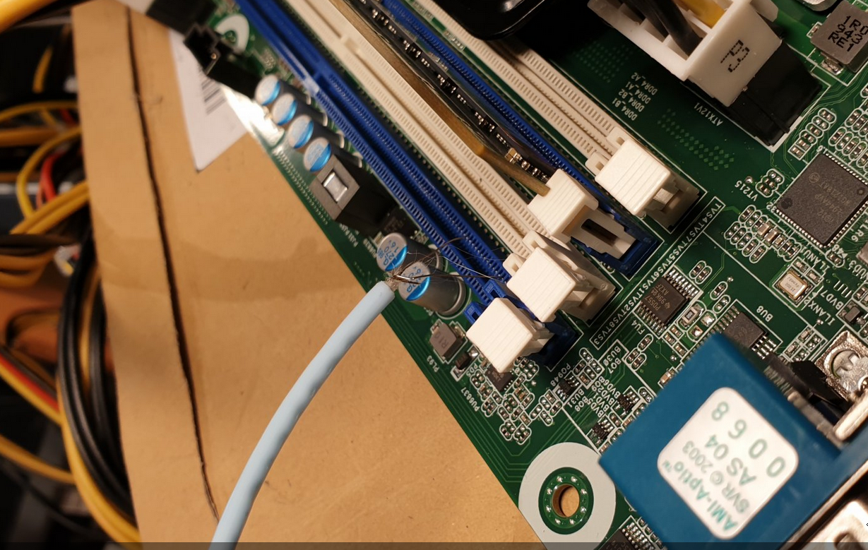

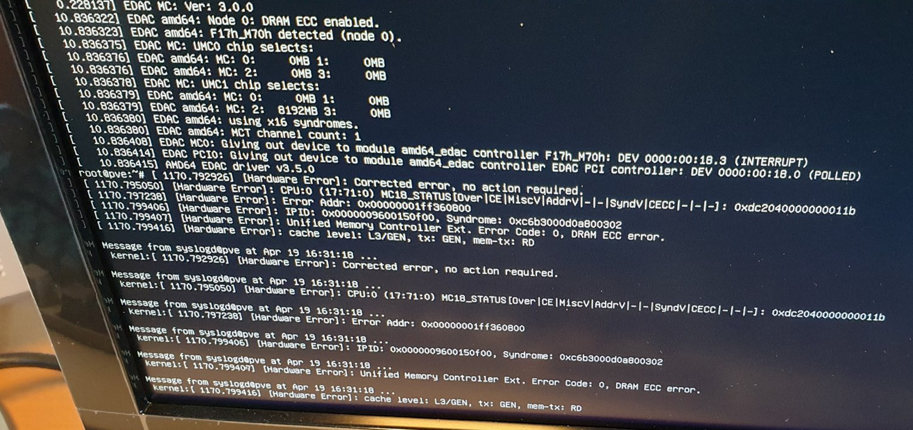

The method I used was to use the inner wires of some electrical cable and stick it in the memory bank with 8GB ECC UDIMM in it. I understood that FreeNAS does not support ECC reporting if I understood correctly so I tried
using proxmox
root@pve:~# pveversion
pve-manager/6.1-8/806edfe1 (running kernel: 5.4.24-1-pve)
I saw the report of corrected errors. From the 2 boards only the X470D4U has IPMI as far as I could tell but the IPMI log is not showing any ecc errors :( which is a mayor oversight from the manufacturer if you ask me. Let's hope they can fix that in an update.

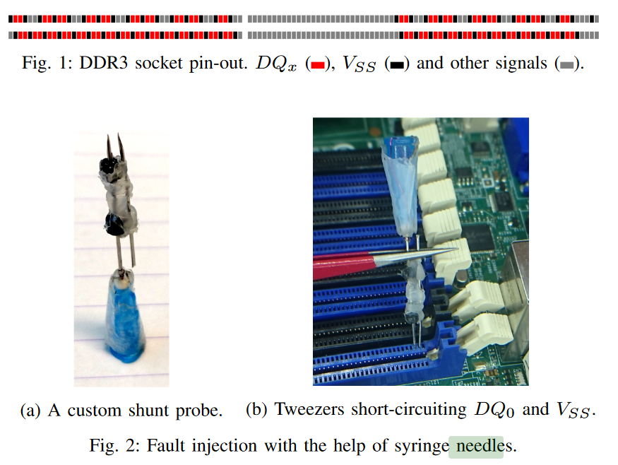

Causing memory errors by shorting pins of memory modules
Firstly I did some research on this "Triggering memory errors using 'needles' or wires"-approach, which Diversity has used. I didn't look into this method yet, as it seemed too risky and I didn't want to damage or degrade any of my hardware.
I found a good (but complicated) description in the following paper:
Error injection with a shunt probe.To reduce noise and cross-talk between high-speed signals, data pins of the DDR DIMM (DQx) are physically placed next to a ground (VSS) signal. As the ground plane (VSS) has a very low impedance compared to the data signal and because the signal driver is (pseudo) open drain, short-circuiting the VSS and DQx signals will pull DQx from its high voltage level to “0”. Depending on the encoding of the high voltage, this short-circuiting results in a 1-to-0 or 0-to-1 bit flip on a given DQx line.Figure 1 displays the locations of the important signals andshows that a DQx signal is always adjacent to a VSS signal.There fore, to inject a single correctable bit error, while the system exercises the memory by writing and reading all ones,we have to short-circuit a DQx signal with VSS. We can achieve the short-circuiting effect with the help of a custom-built shunt probe using syringe needles (Figure 2a). We insert the probe in the holes of the DIMM socket as shown in Figure 2b. For clarity, we omit the memory module from the picture. We then use tweezers to control when the error is injected by shorts-circuiting the two needles and thus the targeted DQx and nearby VSS signal. This method, while simple (and cheap), is effective in the case of a memory controller that computes ECCs in a single memory transaction(ECC word size is 64 bits) and can be used instead of expensive ad-hoc equipment [30], [31]. On some systems (e.g., configuration AMD-1) data is retrieved in two memory transactions and then interleaved. Because of the low temporal accuracy of the shunt probe method, an error inserted on memory line DQk (0≤k <64) that appears on data bit 2*k will also “reflect” on data bit 2*k+1 inside the 128 bit ECC word. In this case the syndrome corresponds to two bit errors and contradicts Proposition 1. To ensure single bit errors, once the interleaved mechanism is understood, the exercising data can be constructed such that the reflected positions contain only bits that are encoded tolow voltage, essentially masking the reflections.
So in short, you're connecting a data-pin with a ground-pin, so that the current on the data-pin "flows away" into the ground-pin and this "flips a bit". When using the correct pins and not accidently shorting anything wrong, this should actually be "reasonably safe" to do I think... (please correct me if I'm wrong :) )
Why is this causing single-bit errors and not multi-bit errors? I THINK because every "clock tick" data is pulled from each data-pin of the memory module. So if you change only the "result" of 1 pin, you get a maximum 1 bit flipped per "clock tick", which ECC can then correct. (not sure though)

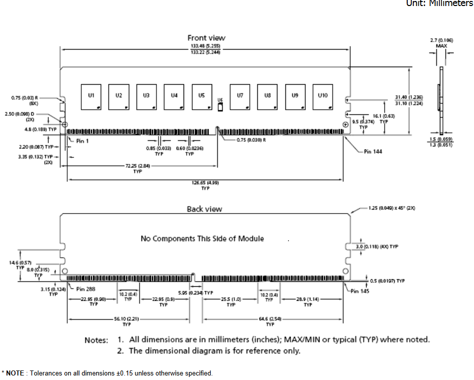

As the paper was for DDR3, you of course need find the pin layout of DDR4, before you can apply it on Ryzen. Following datasheet has pretty clear pin layout of unregistered ECC DDR4 module:
On page 6, 7 and 8 you can see the description per pin and on page 17 you can see a picture of where those pin numbers are on the memory module. I suppose all VSS-pins are ground pins and DQ+number pins are data pins. So if we follow the example of the paper and short DQ0 with a VSS, the corresponds to shorting pin-4 (VSS) with pin-5 (DQ0). But I guess shorting pin-2 (VSS) with pin-3 (DQ4) could work equally fine.
This should help us "understand" a bit better what Diversity has done and how to "safely" reproduce it.

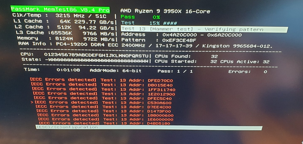

I was in contact with Diversity and have some more details on his testing (all pictures in this "chapter" are from Diversity himself). Diversity used the following video:
https://www.youtube.com/watch?v=_npcmCxH2Ig. Instead of needles and tweezers, he used a thin wire, as in the picture below.
He was able to trigger "ECC errors" in Memtest86 and "Corrected errors" in Linux (Proxmox).

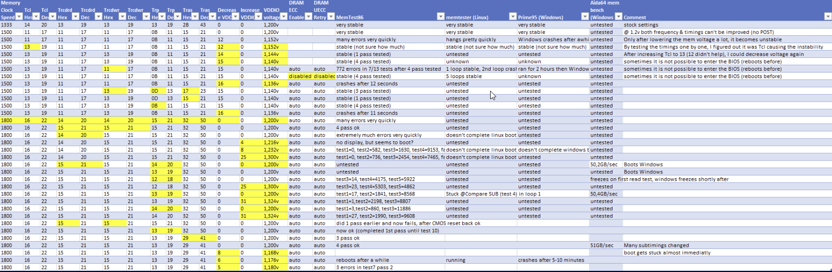

During all my testing I tried 100+ possible memory settings, using all kinds of frequencies, timings and voltages, of which 10-30 were potentially in scenario 2) or 3). I "PARTLY" kept track of all testing in the below (incomplete) Excel:
This convinced me that I should have at least once been in scenario 2) or 3), where I should have seen corrected errors (but didn't). That is why I concluded that it didn't work and I contacted Asrock Rack and AMD to work on this.

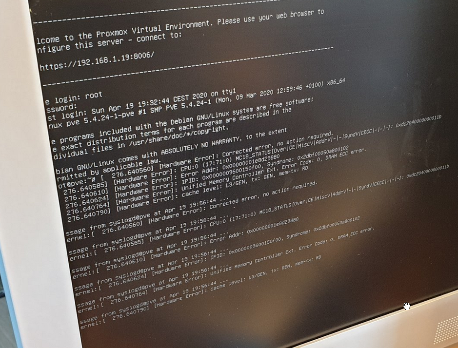

In Proxmox screenshots I do read things like "Unified Memory Controller..." and "Cache level: L3/GEN...", but again, I'm not entirely sure if these mean that the errors are in 2) or 3) instead of 1)...
