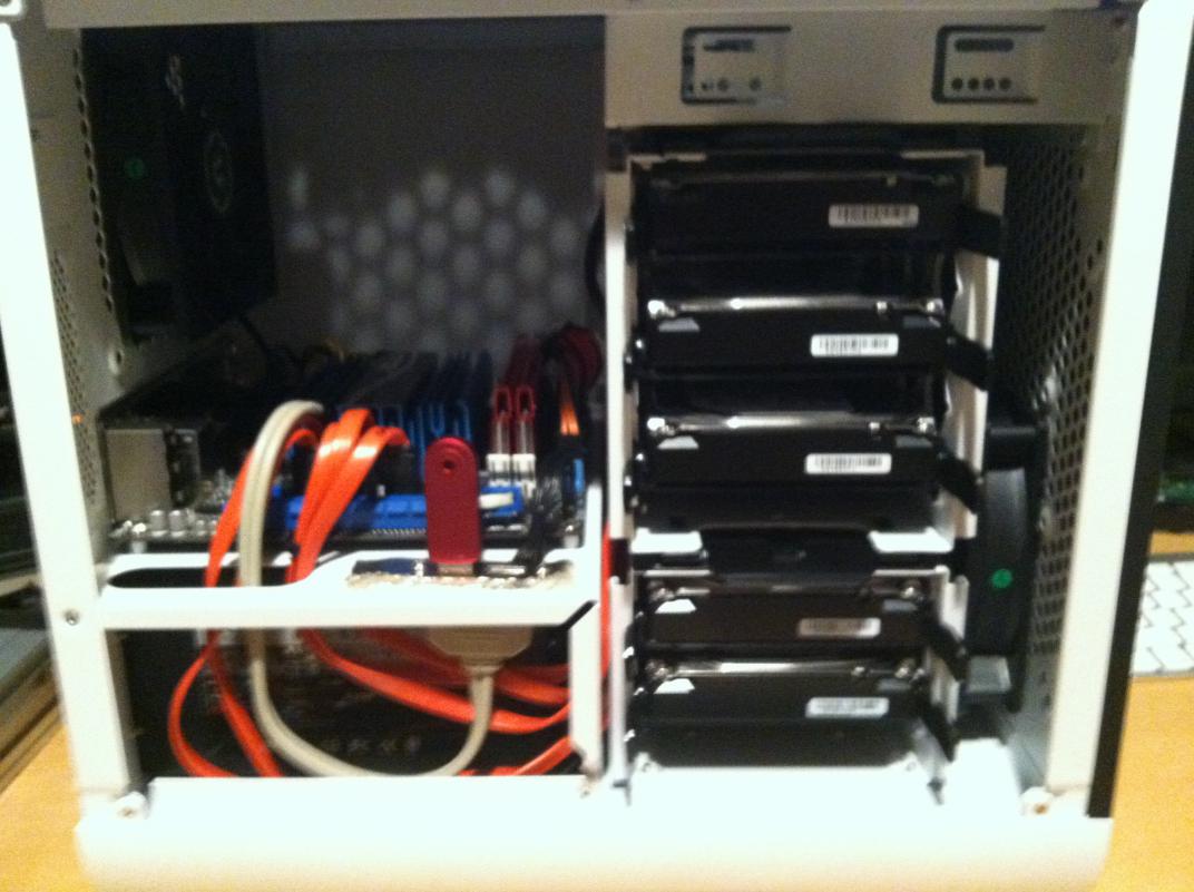

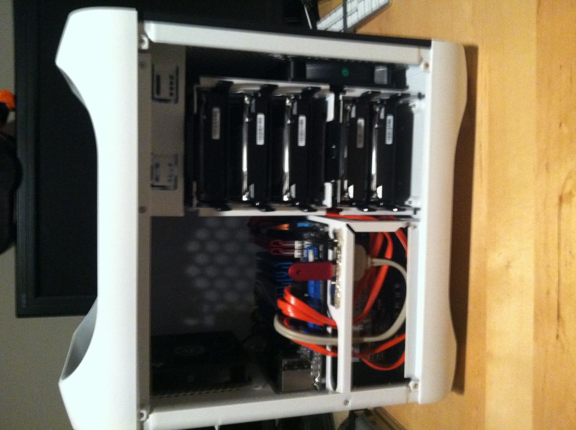

with just a limited time to test (from my mac) I was able to copy over 20GB of data in a little over 6 minutes. This seems pretty fast to me! I completed building the system and am reloading it now as I had major issues with 8.2 Release--could not create new users and set permissions. Loading 8.0.4 P3...
