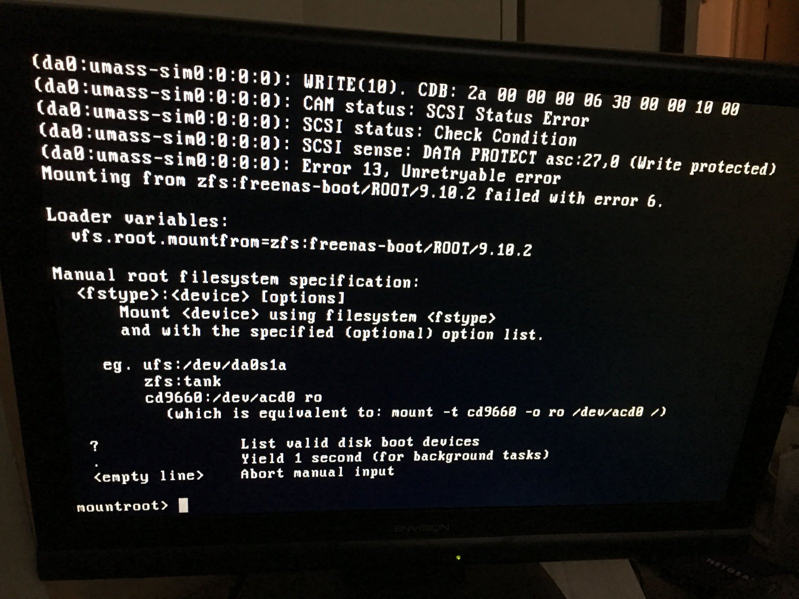

Today I realised, that its not on the LAN at all. So I plugged in a screen and saw following error while booting.
Trying to mount root from zfs:freenas-boot/ROOT/FreeNAS-9.3-STABLE-201503270027[]...
(da0:umass-sim0:0:0:0): WRITE(10). CDB: 2a 00 00 00 06 38 00 00 10 00
(da0:umass-sim0:0:0:0): CAM status: SCSI Status Error
(da0:umass-sim0:0:0:0): SCSI status: Check Condition
(da0:umass-sim0:0:0:0): SCSI sense: DATA PROTECT asc:27,0 (Write protected)
(da0:umass-sim0:0:0:0): Error 13, Unretryable error
Mounting from zfs:freenas-boot/ROOT/FreeNAS-9.3-STABLE-201503270027 failed with error 6.

Is this how the error showed up for you?
