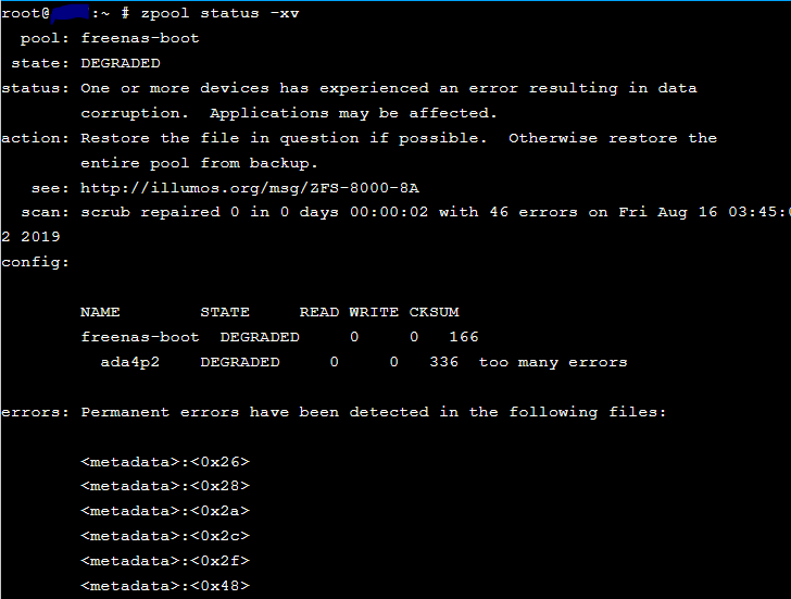

Hey guys,
my freenas-boot is degraded since today.
FreeNAS-11.2-u5
MB: Primez 370-P
RAM: 2x Kingston KVR26N19D8/16 (16GB 2Rx8 2G x 64-Bit PC4-2666 )
Root SSD: 1x WDC WDS120G2G0B-00EPW0 (WD Green 120GB SSD m.2)
HDD (Storage): 4x Seagate ST8000VX0022 SkyHawk 8 TB (8,89 cm (3,5 Zoll) 256 MB Cache, Sata 6 Gb/s)
The command zpool status -x fives me following answer (attached files fn1 & fn2):
There are even more corrupted files, but nothing special.
I visited https://illumos.org/msg/ZFS-8000-8A but i don't really understand what I have to do.
Unfortunately, the data cannot be repaired, and the only choice to repair the data is to restore the pool from backup. Applications attempting to access the corrupted data will get an error (EIO), and data may be permanently lost.
As I understand I have to restore a backup (i have a backup). But does this really solve the problem? Or are there another important things I have to watch out for?
Sorry I am a newbie who can't handle manuals.
I am very grateful for any help, if there are some questions about the issue: Please just ask me.

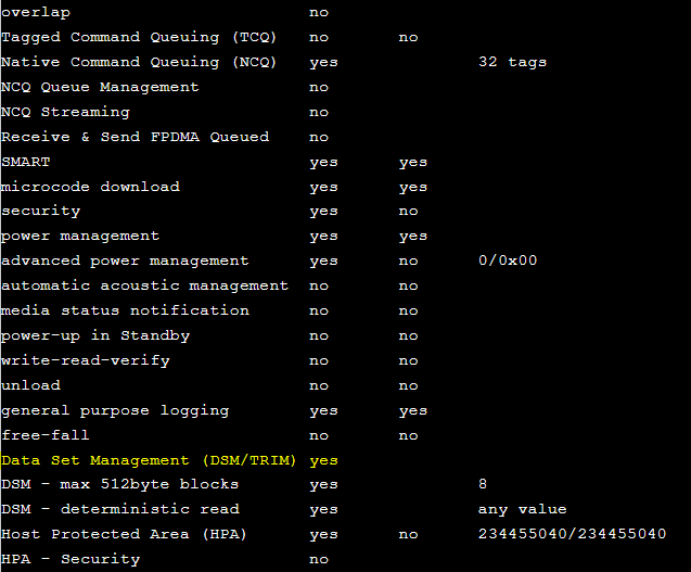

1. Is there a risk to disable TRIM if it was enabled (picture enabled.PNG )?
The WD Green 120GB SSD m.2 would support TRIM (picture trim.PNG ).

If you've already installed to a bugged device with TRIM enabled, the corruption will be there in the pool, and won't be detected until after a scrub or a read of the affected record.
The bug tracker hasn't quite nailed it down as to what the exact root cause is, but the current suspect is something wrong in the NCQ TRIM implementation.

This is related to an SSD controller bug. The only current fix is to disable TRIM prior to the install (via editing the GRUB line) and then ensuring that it stays disabled afterwards.
https://jira.ixsystems.com/browse/NAS-100276
Okay I'll do a fresh install in the next few days and deactivate trim via GRUB before booting.
I will give a feedback if it worked or not.

This was the solution which worked for me! It seems like it indeed was the trim function.
Now three days after the fresh install with disabled trim I don't get another errors!
I'm absolute happy! Thank you very much for your help guys! :cool::cool::cool: *thumb up*
