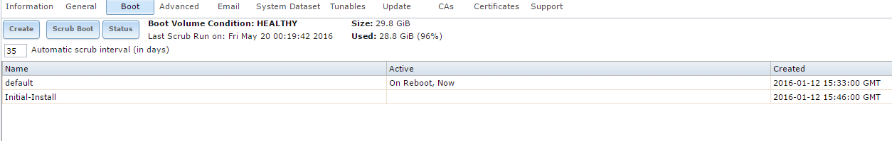

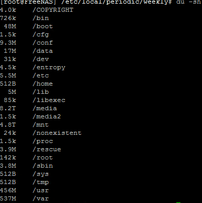

Got a alert for the freenas-boot volume is at 96%,
Ran "du -sh /*"
4.0k    /COPYRIGHT
726k    /bin
48M    /boot
1.5k    /cfg
9.3M    /conf
17M    /data
31k    /dev
4.5k    /entropy
5.5M    /etc
512B    /home
  5M    /lib
85k    /libexec
8.2T    /media
1.5k    /media2
4.8T    /mnt
24k    /nonexistent
1.5k    /proc
3.9M    /rescue
142k    /root
3.8M    /sbin
512B    /sys
512B    /tmp
456M    /usr
537M    /var

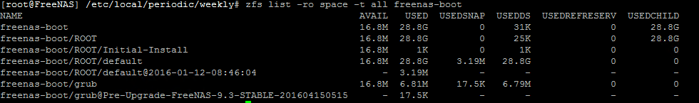

then check the snapshot for the boot drive:
Then check the "System Dataset", it's not on the boot drive:
Then check the space for the boot drive:
No idea where the space go.. :( please help, thank you!!

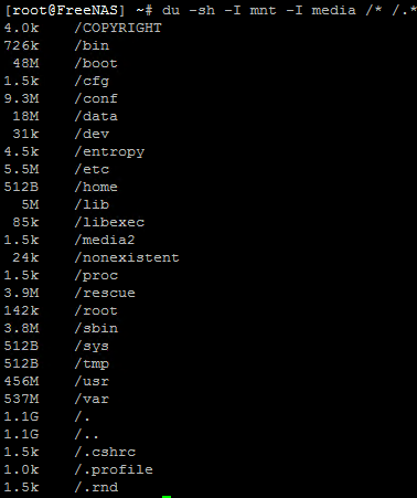

Try this. It looks at hidden files and skips /mnt and /media.
#!/bin/bash
for i in $(/bin/ls /)
do
    if [ "$i" != "media" ] && [ "$i" != "mnt" ]
    then
        du -sh /$i
    fi
done

I figured out how to turn it into a one-liner:
du -sh -I mnt -I media /* /.*
hikurakx
Dec 20, 2015
19
the size still doesn't add up.
4.0k    /COPYRIGHT
726k    /bin
48M    /boot
1.5k    /cfg
9.3M    /conf
18M    /data
31k    /dev
4.5k    /entropy
5.5M    /etc
512B    /home
  5M    /lib
85k    /libexec
1.5k    /media2
24k    /nonexistent
1.5k    /proc
3.9M    /rescue
142k    /root
3.8M    /sbin
512B    /sys
512B    /tmp
456M    /usr
537M    /var
1.1G    /.
1.1G    /..
1.5k    /.cshrc
1.0k    /.profile
1.5k    /.rnd

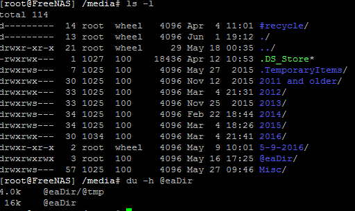

I'm curious, what do you have in /media? Pools typically mount into /mnt.
hikurakx
Dec 20, 2015
19
That's what I figured, but I wanted to make sure.
Yes, media is another NFS mount from the Synology:
mount -t nfs 192.168.x.x:/volume1/share  /media

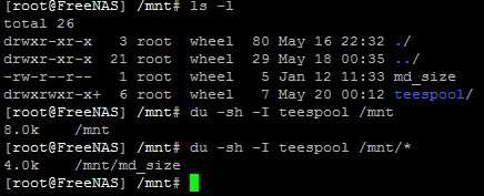

Ah, ok. Do you have any folders in /mnt that are not part of your pool?
hikurakx
Dec 20, 2015
19
I just checked and doesn't look like there are any other folders or files beside the pool.
Sakuru
Nov 20, 2015
527
How about /media? I'm grasping at straws here, this is bizarre.

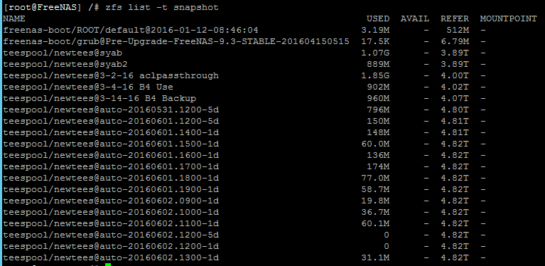

du -sh /.zfs/snapshot/*
hikurakx
Dec 20, 2015
19
I ran
zfs list -t snapshot
teespool is the pool, so those snapshots should be inside the pool right?

freenas-boot/ROOT/default  written               28.3G                  -
freenas-boot/ROOT/default  logicalused           48.4G                  -
freenas-boot/ROOT/default  logicalreferenced     48.4G                  -
freenas-boot/ROOT/default  volmode               default                default
freenas-boot/ROOT/default  filesystem_limit      none                   default
freenas-boot/ROOT/default  snapshot_limit        none                   default
freenas-boot/ROOT/default  filesystem_count      none                   default
freenas-boot/ROOT/default  snapshot_count        none                   default
freenas-boot/ROOT/default  redundant_metadata    all                    default
freenas-boot/ROOT/default  beadm:nickname        default                local
[root@FreeNAS] /#
