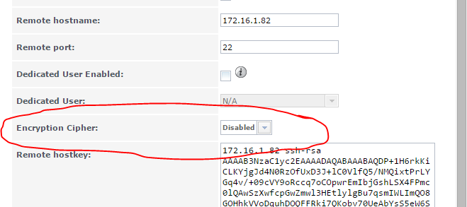

Again, why not ZFS replication? Rsync will copy the whole file, replication will transfer only the deltas.
Also, tell SSH to use 'arcfour', it's based on RC4 and is the fastest algorithm without disabling encryption.
depasseg
FreeNAS Replicant
Sep 16, 2014
2,874
I think I'd have to have ssh re-compiled to enable a 'disabled' cipher.
Not if you use ZFS replication:
