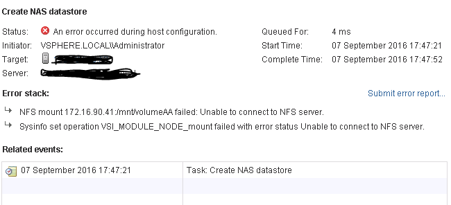

when i mount the nfs datastore it says cannot mount the particular vloume
i tried with vsphere client and ssh the esxi host and tried command type as well

I receive this error

yes but tcp and udp ports iam not able to open the port 111 and 2049 for nfs client
but there is no option to add the ports
