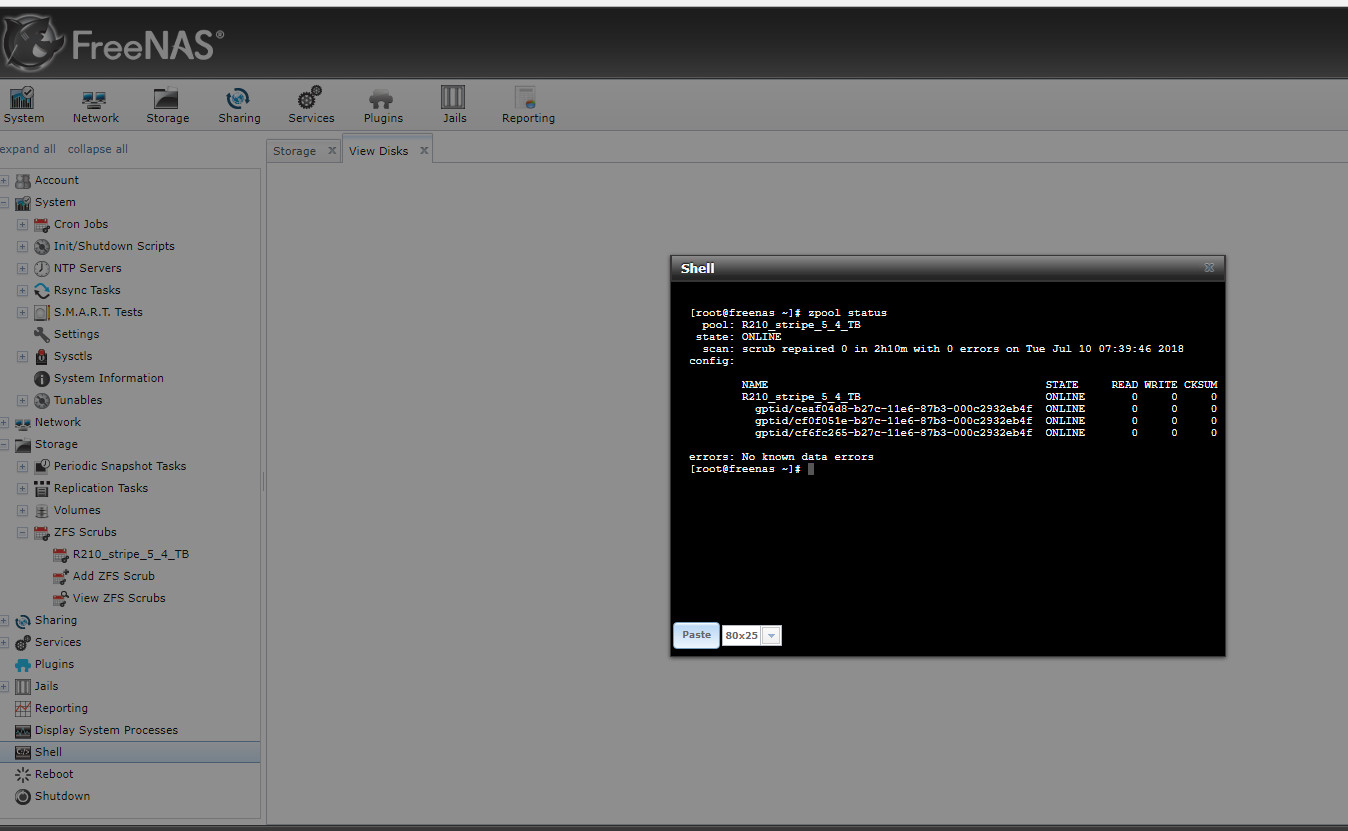

This has been up and stable for over 12 months. the R210 has two internal drive bays, so one 2TB drive is connected via the external esata port. The external drive's power supply failed. I powered down the system, replaced the failed PSU, and powered back up. ESXI can see all four drives. freenas cannot see the three datastores handed to it properly.
A zpool status reveals all is healthy, i forced it to scrub and have zero errors, but the GUI cannot see any drives, shares are gone, etc.
There are more than a few suggestions here that your pool is severely broken:
  • You are feeding VMDKs from a datastore to the FreeNAS VM instead of using PCI passthrough
  • One of the disks backing a VMDK failed
  • Your zpool is a stripe and has zero redundancy
You could browse to the mount point where your zpool is and see if it is present there (/mnt/R210_stripe_5_4_TB perhaps?) as an attempt. Exporting and re-importing the pool as well as manually issuing the mount may also help, but several things were done that make this less than optimal.
