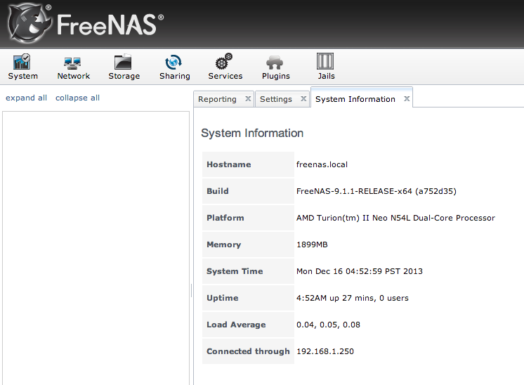

Hi , First time posting for help.
I am running FreeNAS-9.1.1 Release x64 (a752d35)
On
AMD Turion II Neo N54L Dual Processor with 2Gb Memory
I have two 350Gb Drives and 2two 3Tb Toshiba drives installed

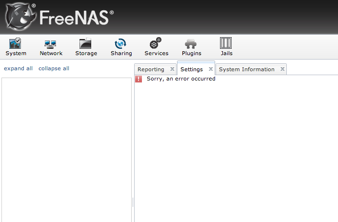

The problem I am experiencing is that the web interface initially works fine and allows me to import volumes I have made previously. Then all of a sudden after about 2-5 minutes after booting it stops working reporting "sorry an error has occurred" and then the web interface finally stops altogether with a 404 Error. The system is ping'able, the console interface is working and the device can be shut down or restarted from the console.
I've tried booting with all the disks out, but the same.
See the images I have uploaded, notice the navigation bar on the left is empty.
Not sure what else I can provide.
I'm wondering if I have the right image?
Any help would be very much appreciated.
Thanks

Well, your problem is almost certainly related to insufficient RAM. You need 8GB minimum for the system to be stable. Upgrade to 8GB and see if the issue persists.
I will warn you that using less can cause unrecoverable loss of data. That's why we've put the warnings like we did in the manual.

Maybe your FreeNAS install is bad. Are you using a name brand USB stick that is at least 4GB?
You could also try installing FreeNAS to another USB stick and uploading your config file.

Also check /var/log/messages for any signs of trouble (use the console interface).

Dusan, CyberJocky...Found it I think...As per somewhat usual its user error....Thinking I was being a right smarty pants, I thought for the purpose of playing I'd put the FreeNAS IP address high in the range at 192.168.1.250, away from everything else in the house.....WRONG!.....I must have thought exactly the same thing when I configured the Western Digital TV box I've got..and yes it was the same address, which is probably why the FreeNAS interface worked for a short while then gave up. Durrrr....beginners error...face palm....glad I found it and I will take on the advice you have given. Dusan thanks for the steer on the log files, CyberJocky thanks for the steer on the memory. Allegedly the HP Microserver I have can only host 8Gb, but I've heard it can take 16Gb so I might just go for that... Again thank you both for your help, very much appreciated.
