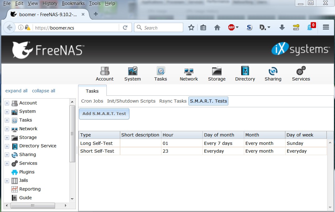

Have you scheduled SMART tests on your system? If not, now would be a good time... Here's a screenshot of the SMART test setup on one of my servers:
In the meantime, you can run some tests right away. Start a shell and run: smartctl -t short /dev/ada0 - this will start a short test of the drive. You'll have to wait a few minutes for it to finish; the smartctl program will in fact tell you roughly how long to wait. Then run this command: smartctl -a /dev/ada0 to query the drive for the test results. Post the result between CODE tags, like this:
