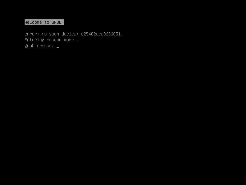

just updated to freenas 9.10.1 and got this:
index.php
im new to freenas and dunno how to fix it

It's possible the stick died. Try a fresh install of 9.10.1 on a new stick and restore your saved config.

Where do they look ONLINE? The pic you posted shows the system doesn't even boot.

Same problem here with 2 mirrored USB sticks. I don't think it can be possible that everyone's USB boot device died simultaneously post 9.10.1.

Looking in rescue mode, it doesn't look like grub is able to read from either USB boot devices. Attempting to list either one shows "unknown filesystem". Not sure if this is expected.

Both of my home systems with mirrored USB boot devices show grub in rescue mode as well.

Upgraded in the GUI and now getting exactly the same screen...
Please escalate! This is not an isolated event, and systems are down!
