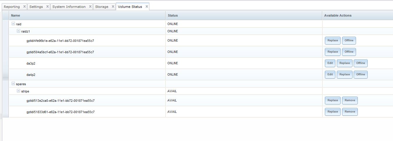

Hi there,
I was testing the new version of freenas on a custom box I recently put together ( HP ML350G5 with a LSI2008 in IT mode) and I noticed while testing disaster recovery, if I disconnect the disks freenas doesn't acknowledge the removal on the web interface and doesn't kick in the hot spares. I removed a few other disks and the same thing happened. On the console, I can clearly see the messages about eh disks being disconnected.
Is this some sort of bug?
Thanks

I'm going to test it now on a Dell 2950 with a PERC 5/I, just flashing the card to IT firmware now then I'll do the same tests I did on the HP ML350.
mephisto
Aug 3, 2012
20
I was testing taking more disks out and screwing up the raidz array, I can't access it or do anything but freenas still show as healthy, funny :)

Well I tested the PERC 5/i with each disk presented as raid0, tested taking the disk out and the console again reported everything and the virtual disk was deleted. On the web GUI, nothing, array still healthy, no alarm or anything.
Very much annoying that the first principle of freenas was to have redundancy, I can't even use the very basic features.

Well, actually this happens on 8.2 as well
4 drives disconnected, nothing .... Where is your data pal?
