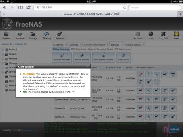

I'm now having this problem on a 1 week old 3 disc RaidZ array of new discs, on a fresh install of 8.2.0-RELEASE-p1 (not an upgrade). Is everyone else getting this full message?:
The volume Z1 (ZFS) status is UNKNOWN: One or more devices has experienced an unrecoverable error. An attempt was made to correct the error. Applications are unaffected.Determine if the device needs to be replaced, and clear the errors using 'zpool clear' or replace the device with 'zpool replace'.​
(Meanwhile, you can see that the status of volumes in the main volumes page background shows the array as healthy. All the individual discs show as healthy in "Volume Status" as well.)
It's that "unrecoverable error" part that has me most worried. Getting this box together and running has been a very long background project, and I was quite excited to get the RaidZ array up and shared and my data transfered over the network onto what I thought would be a sorely needed, high reliability solution. So this is frustrating. Anyway, how can I locate the file(s) in which the error occured? I don't want the "clear" the error in case that would mean that I won't be able to locate the corrupted file(s), and I'm not going to trust anymore files to this system until I can at least sort that out.

I'm experiencing the problem that is the topic of this thread.
Actually you're not. You have a different error. From an SSH session as root.
zpool status -v
freshfeesh
