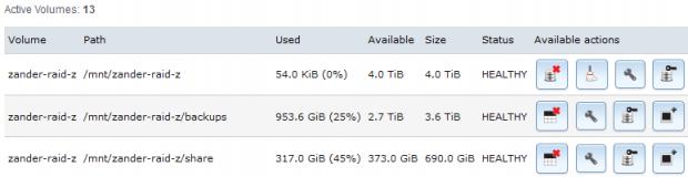

I have a NAS with Four 2-TB SAS Drives setup with RAID-Z. When I originally setup with FreeNAS 8.0, volume size was reported as 5.6 TB. Now FreeNAS reports as 4.0 TB! I enabled SSH and logged in to double-check and df command is showing the same thing. It looks like FreeNAS is failing to make a distinction between available size and total capacity, instead reporting RAID-Z size = available space. This bug exists only for main volume and not for any sub-volumes, as can be seen in this screenshot:
This is normal (if a bit funny looking) - you can see the same effect in the Report graphs.
The parent volume "zander-raid-z"s reported size is the total disk space *less* any disk space taken up by child datasets. This is because datasets can be thought of as a sort of soft partitioning, so any space used in a dataset is no longer available on the parent.
So here you have ~1Tb in "backups" and ~.3Tb in "share". That doesn't quite add up to the missing 1.6Tb but it's close. Do you have some additional room taken up by snapshots, perhaps?
