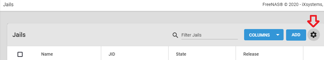

You don't have a jail pool set. Go to Jails, and click the gear:
In the dialog that follows, pull down to your ssd pool, and click Choose. This will properly set the org.bsd.iocage:active property to yes on your pool.

Oh wauw, i thought when selecting a pool during plugin installation that it would either do it for you or tell you to do that.
Did it now and "ssd" was already selected so i just clicked choose.
To be sure it worked, i ran the "zfs get org.freebsd.iocage:active ssd" command after it and i got the same result as before.

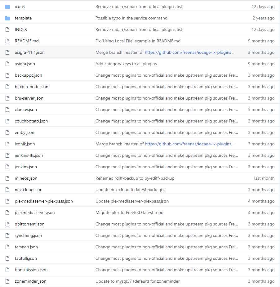

1 small note i do want to make, not sure if it's important, i decided to install the Transmission plugin again to do another attempt at setting it up and i got an error on the plugin install: "Error: Jail: Transmission has a missing configuration, please check that the dataset is mounted."
I did for jail name pick Transmission again so maybe that's why it happened? Something still lingering? I tried installing the plugin again, this time just naming the jail transmission and appearantly not using a capital t was good enough to let the install happen.
Samuel Tai
Apr 24, 2020
5,399
Yes, this is because the plugin definition uses a lower-case t on the back-end.

https://github.com/freenas/iocage-ix-plugins.git lists all the plugins on the back-end:
They're all defined as lower-case. For your emby plugin, check iocage get plugin_name <name of emby plugin>. This should have value emby (all lower-case).
