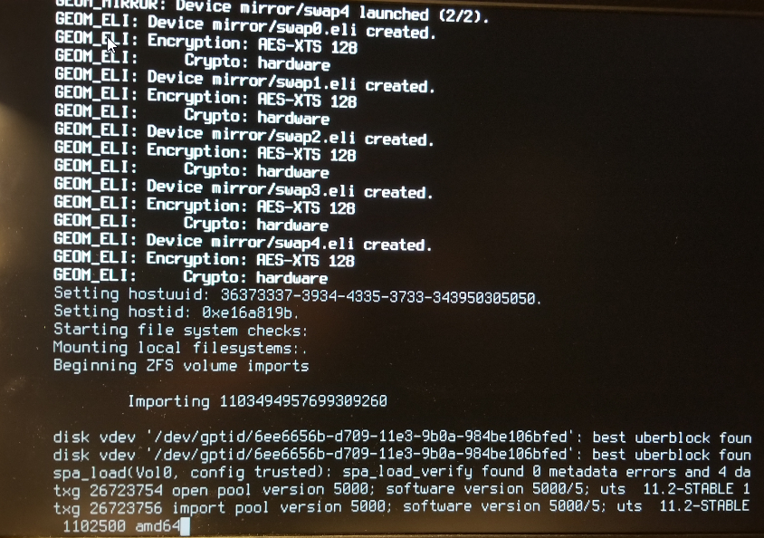

I am currently running Freenas 11.2 Beta 2. Overnight Freenas reboot possibly from a crash and it attempted to reboot and got hung up during a Pool import. I have tried several times to turn of Server and reboot it. It gets to same point before it locks up (At least it appears to be locked up). Below is a screean capture of where it locks up.
Is there any work around to find out what is causing this and have it boot up completely.

That's it? It just hangs there at that point.
Did you get any indicator of why it rebooted itself initially?

That's it? It just hangs there at that point. Did you get any indicator of why it rebooted itself initially?
No. When I woke up, I noticed I had no access to server. Went and check and saw what the screen capture above had. Everytime I reboot, it ends up at same point.
I have not tried to do anything other than try and reboot at this time. Since I am not that experienced with Freenas, I thought Id ask before I tried anything else.
The Drives for the pool are on two 10-bay towers connected to the server. Can I reboot the server with the two towers turned off and once booted turn turn on towers and add pool after freenas has booted? Currently only 15 drives are in use and the remaining fives slots are not in use.

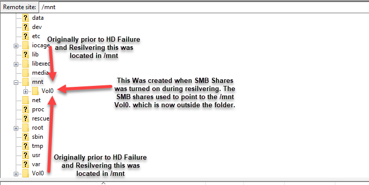

Here is an update. I went through and booted Freenas without drives online. Once booted, I went and turned each Set of drives on, From this I was able to discover that a drive went bad. I was able to replace it and its currently resilvering drive.
New problem is that the plugins were under the old warden system. Now that I have booted and abeen able to get volume back online, I now longer can see the Jails or Plugins under old GUI.
After looking into it further it appears that Volume has been mounted outside of its original location.
Below is a Screen capture of the structure right now. The Vol0 inside the "/mnt" was something created after silvering occurred once drive was replaced and SMB shares were turned on. The Vol0 is a newly created when SMB shares was turned on. The Vol0 which is outside located at bottom of tree is what should have been mounted in the "/mnt". Same with iocage which was also located in /mnt and now is outside that mount point.
I think this may be why the plugins did not start. I do remember during boot after replacing the drive a message came up that Vol0 already existed and was provided a warning.
Not sure how to resolve this especially while resilver is going on which from past experiences takes several days due to the size.

You should have waited for the resilver to complete, then reboot. The system is not configured properly because the drives were not online when the system booted. We were supposed to be doing troubleshooting, not trying to get the shares and services back online.
I told you that would happen. You tried to get services running though and that may have broken things.
They are not working because the path is wrong. After the resilver you should be able to reboot the system clean and the vol0 will be mounted where it is supposed to be. You need to turn off SMB and delete that new folder that was created.

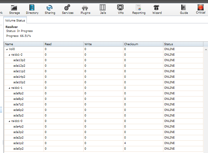

So it is all one big vdev? Could you please share your zpool status? If that is what you did, and used SATA port multiplyer hardware, that is why it is so slow to resilver. I used port multiplyer hardware myself, as recently as a year ago, but it was not reliable for me. It was probably the drive failure that caused the reboot in your system, but it should not have. That is something I have seen a couple times with the BETA release. Please report that as a bug, so that the development team can see the crash data and try to get that fixed. The system not booting was probably the result of the port multiplyer hardware. I had that happen many times on my NAS and it is part of the reason I stopped using the port multiplyer. When did you upgrade to the BETA version? The driver for the port multiplyer hardware wasn't working properly for me since getting 9.10, but I was still getting it to do the work until 11.0. What version of FreeNAS were you using before you upgraded to the BETA?
Jerzy Sobski
Mar 6, 2015
50
Yes I believe so. (Note sure what vdev means)
No, not one big vdev, but I think I should get you to look at some material to help you with your terminology. Please look at these resources when you can:
