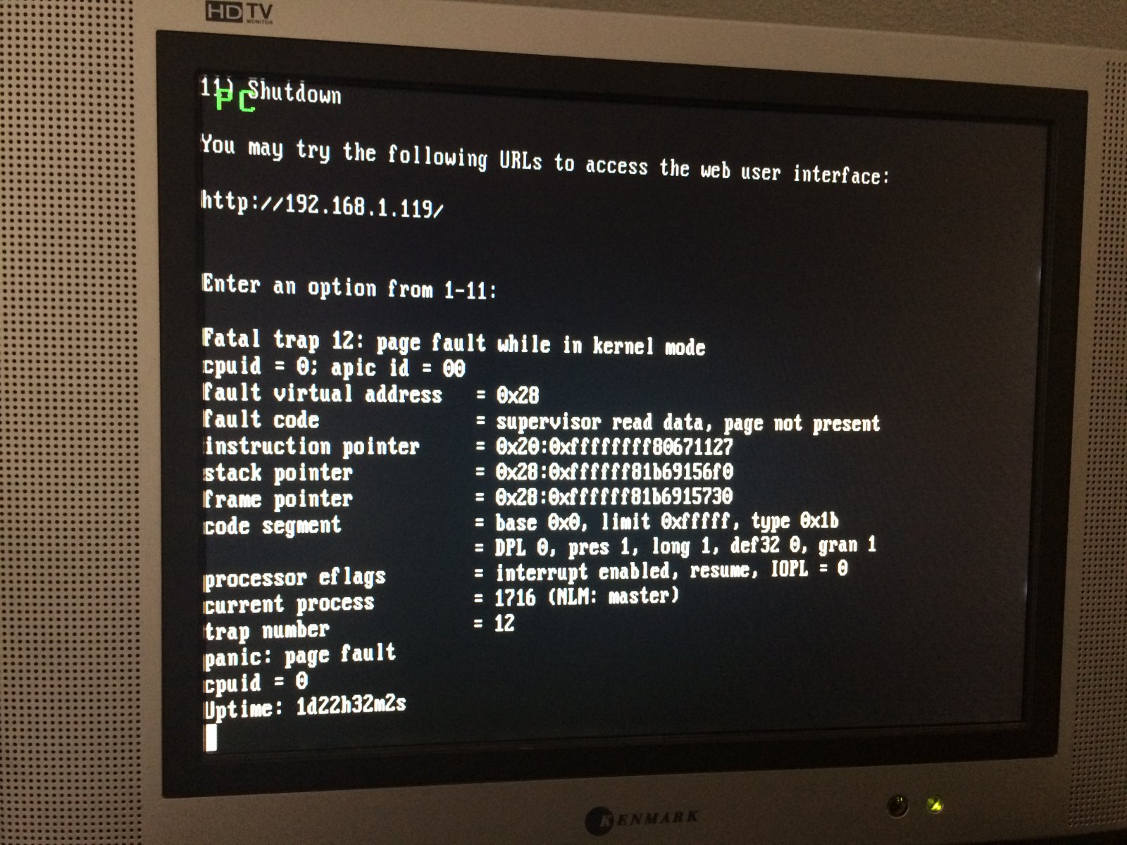

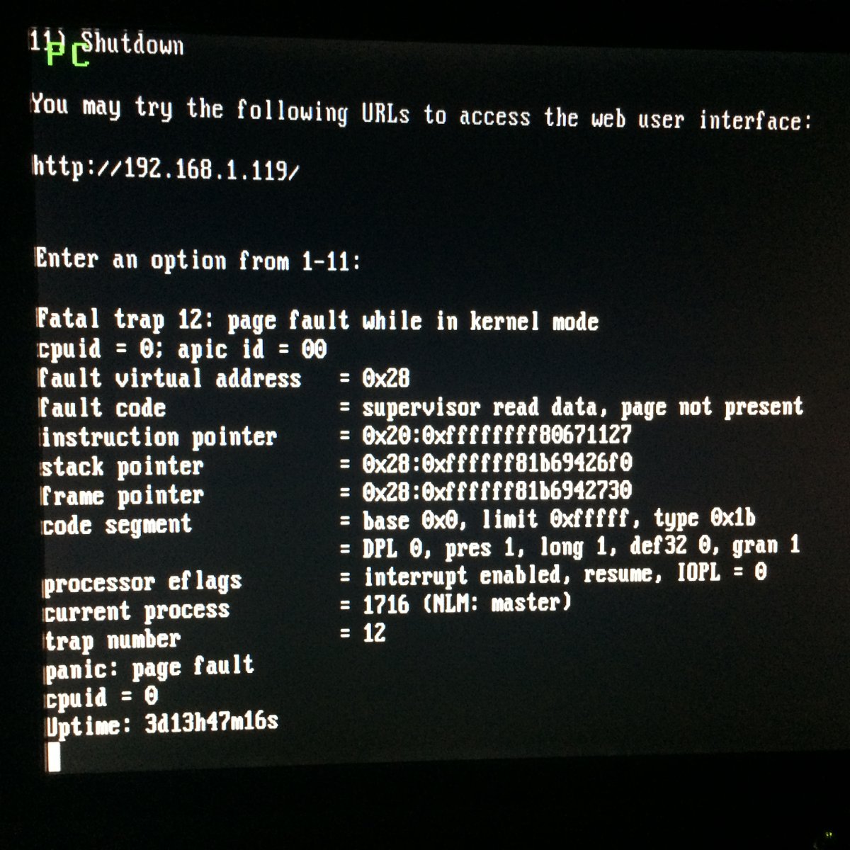

Over the last 2 weeks however, my luck's changed on that front. It seems that every 18-36hrs or so, my server will completely lock up and display "fatal trap 12: page fault while in kernel mode" I've attached a couple screenshots below.

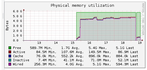

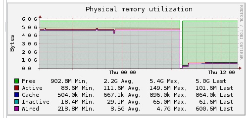

When the crash happens, it's always during a time when the system is idle, and I've noticed a pattern that it likes to crash around 7:00-7:30am. Looking at the memory graphs, there is still memory free, but the usage pattern looks a bit odd.

Does anyone have any suggestions on things I should be trying to remedy this?
