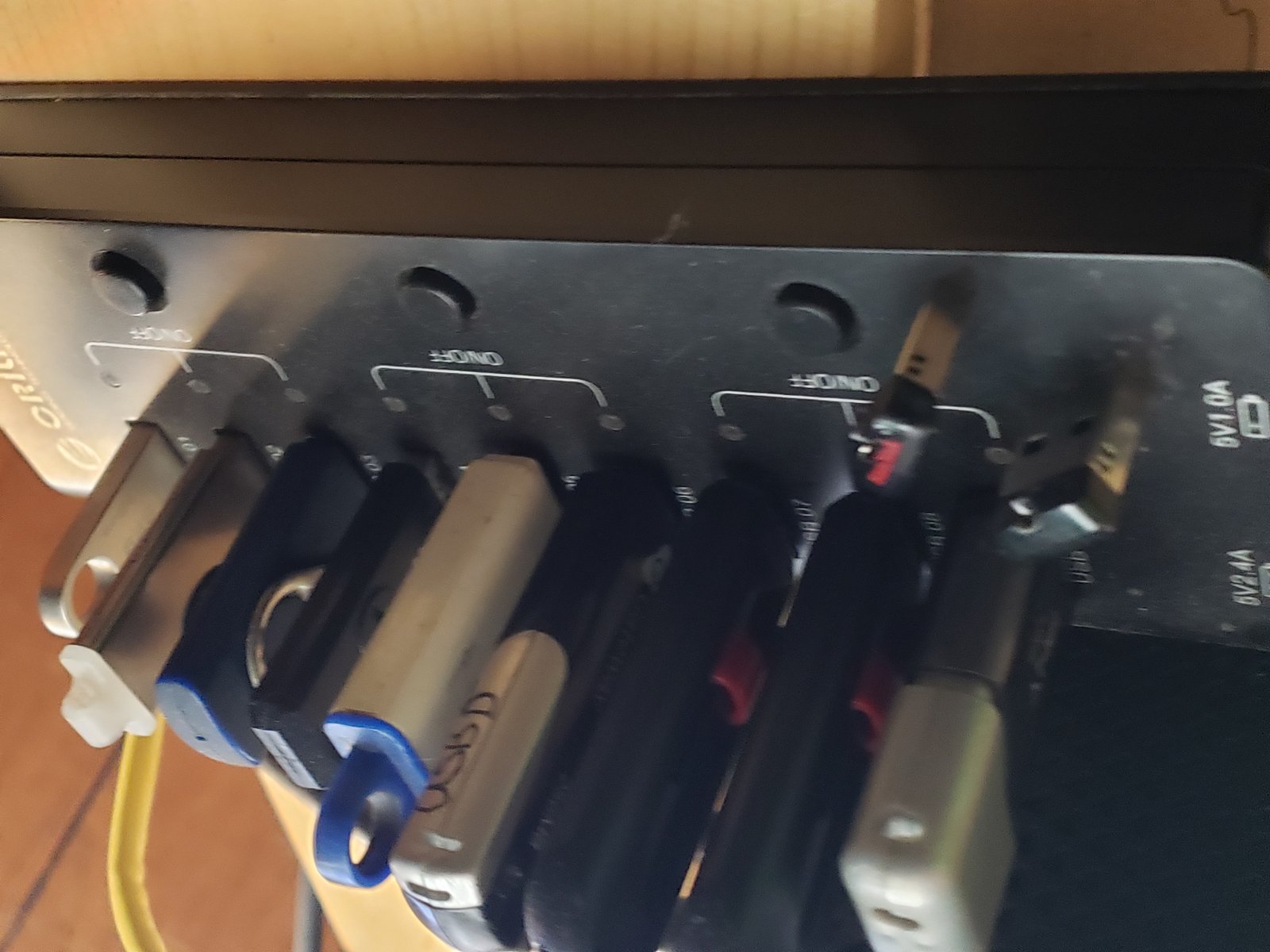

On a side note I would still replace your USB with a SSD you can find 120Gb for under 30 Bucks. Here is a pic of all the failed USB'S that have Cause me pain & had to reinstall FN. I am surprised they have not change the standard to show that USB'S are no longer supported with the newer versions of freenas.

Thanks! And, wow. That's quite the pile of USB sticks. Not only are USB supported, but they're recommended. I do agree that anything larger (in size) is an incredible waste of space but due to failure rate, USB can be rough and also make troubleshooting a bit of a hassle. SSD's will certainly last longer but, I'm my case, unfortunately, I have no free bays for one (and no 2.5" bays either). So, I'd have to go external which can be tough in a tight rack. As long as I have backed up configs, I'm a happy camper! If I did have internal space, I'd certainly go with mirrored SSD's, though. Thanks again!
