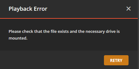

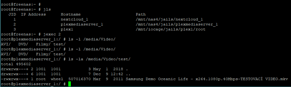

I have suddenly lost access to media files in plex plugin.
I can see media files in plugin, but Plex no.

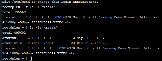

Based on the numeric UID and GID, you are looking from the appliance side.
Can you see the files in the *JAIL* side? Is that storage "mounted" ("added") to the jail config?

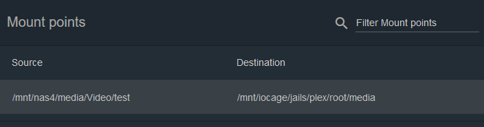

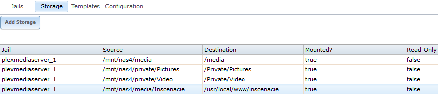

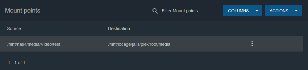

This is from "storage" view.
It's old warden plugin, I have updated Freenas to "FreeNAS-11.2-RELEASE, but not plugin yet.
But I tested to create new version plugin, add storage, and it's the same.
I see file inside plugin, but plex server is not seeing any files?

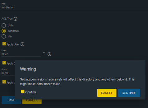

I've found the problem. I've looked at my .history and remember what happend.
I was setting up group access for my windows smb share and working with permissions. (removing "everyone" access}
When I set them again recursively, everything works again.
So the problem is now solved.
