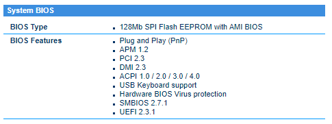

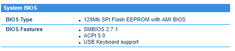

i thought it does not support UEFI before because it does not list UEFI as its BIOS feature compare to later X11 generation.
from X10SLM-F
from X11SSH-F
