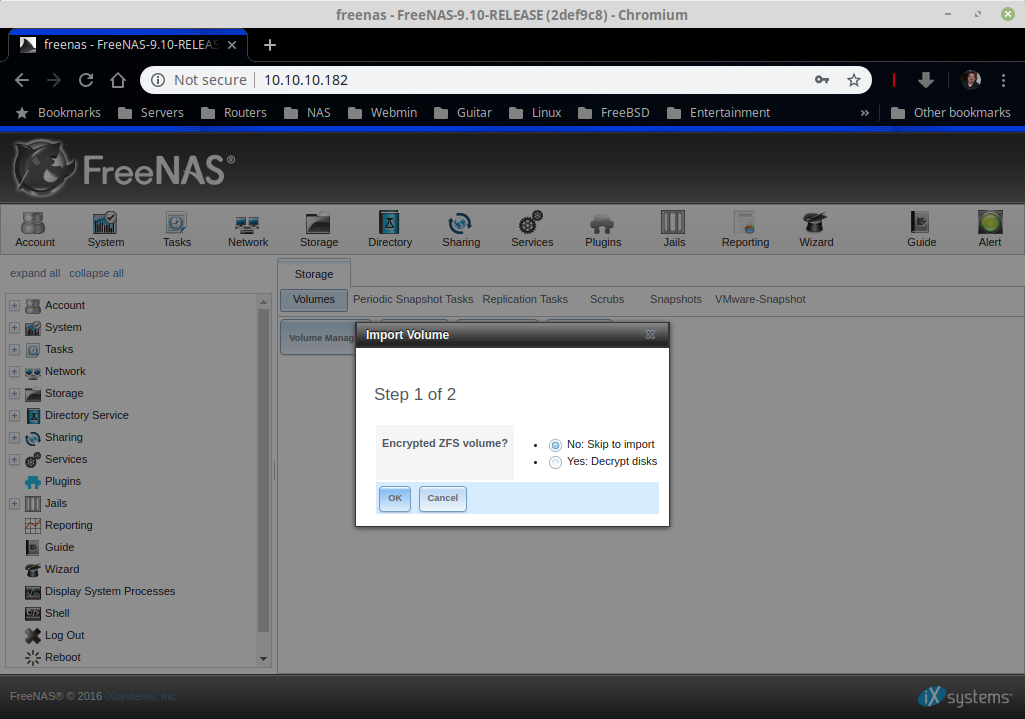

Try:
Go to Storage
Import Volume
Select No if not Encrypted (Hopefully), Click OK.
Click the dropdown to the right of Volume
If your pool is listed, select it and continue; setup your users, exports (SMB/NFS), etc.
If your pool is not listed some work will be needed from the shell.

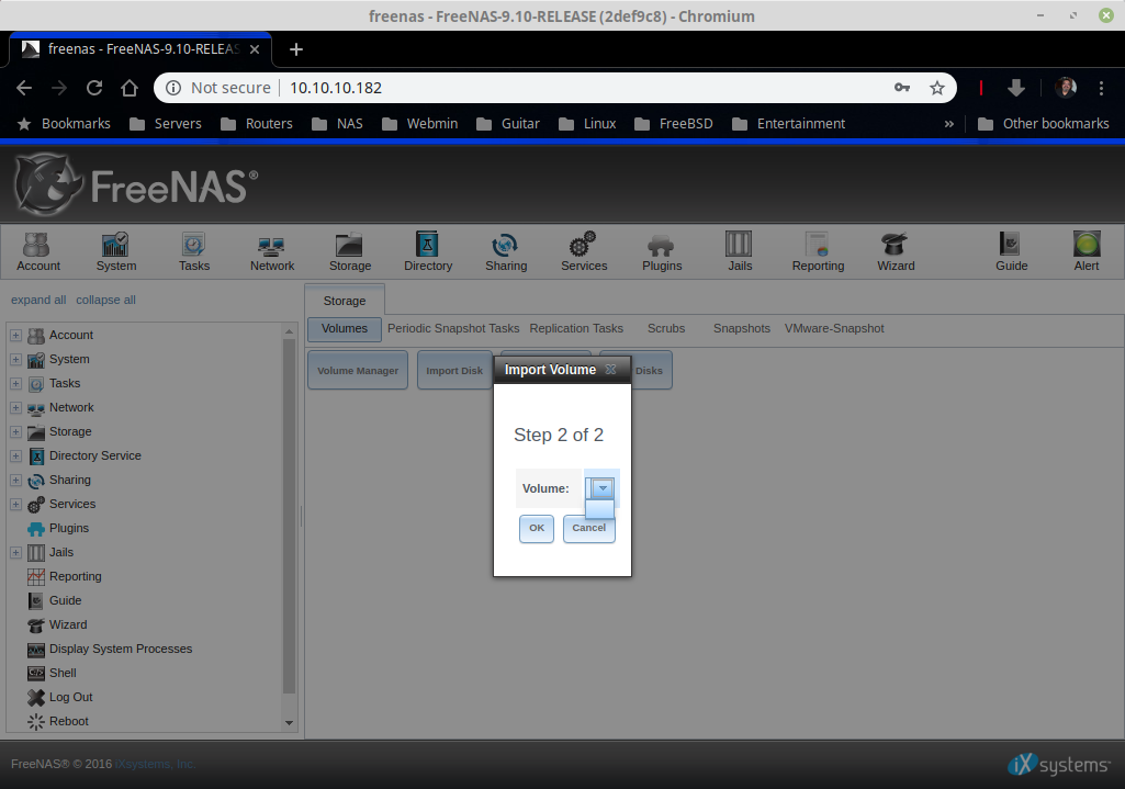

In the second step 2/2 I do not see any pool in the drop down list in my current version of 9.10. My question is if I install the latest version of freenas on new pen drive, can I able to import my pool from my existing storage drives? But on the other hand if I use \\freenas on command line, I can see my two shared folder.

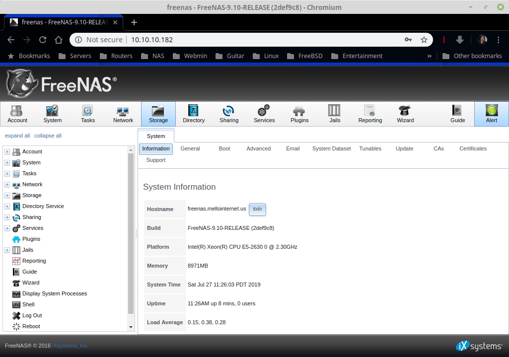

Currently it showed 11.0 build
I have managed to boot from old version 9.10
What was the version you were running? Use the same version to reinstall and try to import the pool.
That wouldn't be possible with a fresh install. Either you are still running the "original" install or you made the changes/imported config.
Please back rack your steps, install the same version you had running, and re-try import. You will have to re-configure all settings, including users/shares/etc.
