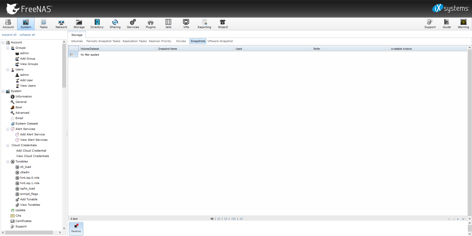

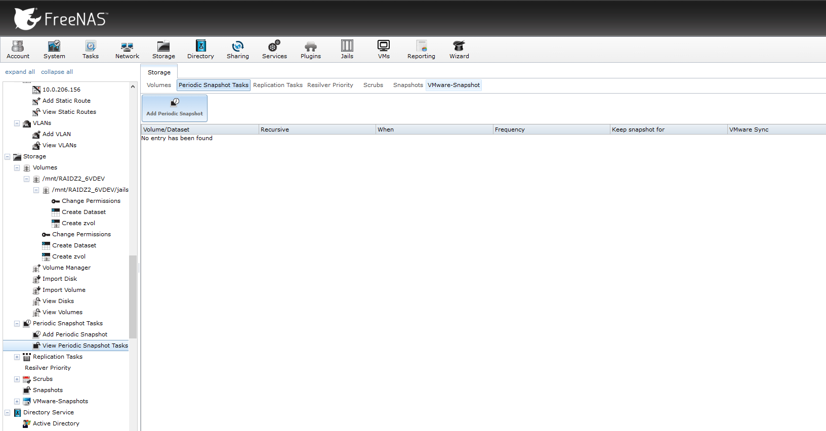

I have set up a freenas storage from 2 years now and did something like "set and forget", which in my case is not that good because my freenas storage is not that small, it has 60 SAS disk 8 TB each one and it is combined in 6 RAIDZ2 and at the top of those RAIDZ-s there are 2 volumes, each of them is 160 TB. It has been working for 2 years and did had any problem at all, suddenly before 2 days i see that one of the volumes goes offline in that windows server where it is exposed, the first thought that came to my head that moment is that something strange has happened and I try to bring the volume online but I did not had luck, than I tried something else (command promt, DISKPART, "select disk X", online disk) and the volume came online but the I had read only permissions, than I entered to web interface of FreeNAS and i see a warning, "The capacity for the volume 'RAIDZ2_6VDEV' is currently at 84%, while the recommended value is below 80%. " and than when see one of the volumes it says that it used 100% menawhile the same volume in the windows server where it is exposed is shown with 18 TB free. I do not have snapshots configured for my freenas. I have read that when FresNAS is above 80% is decreases it's performance but in this case I can not add anymore data in that storage. And from the FreeNAS shell i can not see the files in my volume so that I could delete any file.
I have been reading those forums for 2 days and have not found anything that could help me, can anybody tell me what is happening with my storage and how can I fix this?
Atach there are 2 images that maybe will help
Thanks in advance!

@garm regarding my homework, I do not work as a storage guy or system administrator in my everyday, I am a network engineer and I have given my help to set up the storage before 2 years and for a simple explanation above I just said "I have set up a freenas storage from 2 years now and did something like "set and forget" ", and the our system admin guy is not working with us anymore and this company assigned to me his duty just for some time till we find another system admin, and this is the situation where I am now and when see that windows reports smth else from freenas I thought that it might something like a small trick that I don't know to free up some space in that volume, and in the country where I live the owners of the business they do not pay for those kind of things(this is one of reasons why we went for freenas with this big storage) so my last option was to write on those forums for any advice, so it would be more helpful to me if someone could give me an advice rather than doing assumptions. For ex. can you tell why the dataset says the is 100% used meanwhile one of the volumes has still free space? why the same volume in freenas is 100% used meanwhile in windows server shows still free space? What can I do to free up some space in this volume while the volume in wondows is read only? I do have one other storage that I could back up all the data of this volume and than destroy the volume and recreate it again, but I am trying to find a solution that would not request this kind of thing. @majerus in atach is screenshot of snapshot
