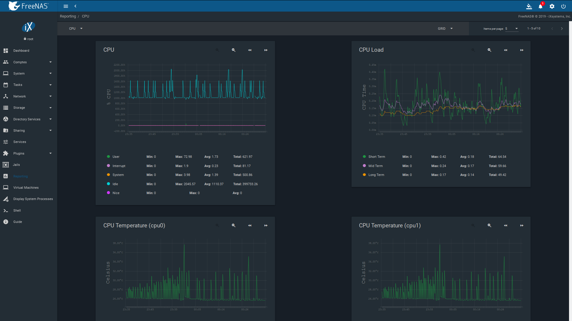

Usage stats : In attached picture
I also used "top" to see the CPU usage for every running program.
I know SMB is not pretty good but it demonstrates that the drive can handle r/w operations with a correct speed for this model, so it's not the disk speed that cause the delay.

Drive : 1 x 4 TB WD Red (for the moment)
And that's probably your problem right here.... Almost certain this drive is SMR. Confirm the exact model and if it is SMR, you will have to replace it with a CMR drive like Seagate IronWolf.
